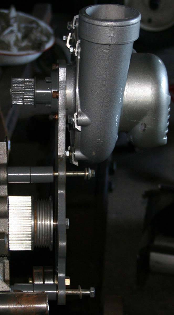

Here is a side view of the BDT

Is that the actual pulley that will be used in the final setup? Do you have the specs for that pulley? I was just curious of the PD of that pulley and belt type.

Pulleys
There are three pulleys; the double pulley which the accessory belt drives and the single pulley behind the compressor. Which one were you referring too? The belt is a standard belt made by many; I'll post the brand/# tommorrow.
We will not know if this is the final pulley setup until we are up and running and can accurately determine the resulting boost. We do not want to exceed 6lbs.
