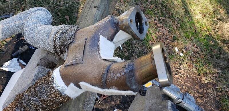

Hi HRLNKN, I appreciate all the detail info about the only tubular header made for the AMV8 and adaptable to the AJV8 and Lincoln 3.9l. I considered the headers but I don't have a tig welder or knowledge of a specialist to modify a set a pipes that deserve A1 work. To increase the flow i had to place a Bassini X-pipe where the mixing chamber behind the catalytic converters. This one mod allowed the power into 4500+ than 2800 rpm. Thus mid range is realized. Fun! The second mod i did was to fully insulate the exhaust sys from the manifolds to the mufflers with Kaowool and fiberglass. This kept the air hotter and the air density lower further down the pipes. I notice better acceleration after insulating without the x-pipe installed. The hottest reading was 600-650°F (Fluke IR Therm) after getting off the road from continuous freeway travel. The cabin is cooler and the engine bay is not nearly as hot deteriorating the rubber and plastics under the hood.
