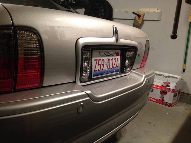

Mid-march, so work is very busy - but I found some time to get the LSE tails on the car, and I love them! Also got my new center vent in, wipers, new radiator cover trim fasteners, and I also removed all labels from that cover and headlights to clean up the engine by a bit. Found out my fuel filter has one quick release, and one spring style clamp on it - I am assuming I need the cheap tool for this, so I will have to grab that before swapping this one out.

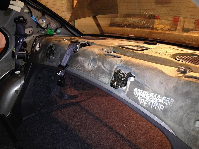

One of the rear deck woofers are cracking on lower/bass notes. Seems this is fairly common for LS's, even the THX vehicles? Since the shelf is off, and the speakers mount from the top, I am ordering a new pair and will re-assemble when they arrive.
Found THESE - hopefully they work out okay. Speakers are covered under ESP care, but with the $100 deductible and me already doing this work, it was not worth it for me to take the car in for it.

One final comment, with the parcel shelf off the backup sensors are LOUD! :D
