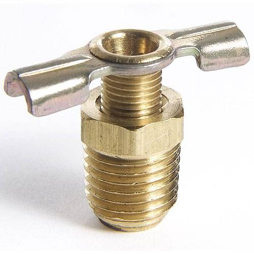

Heck, just 1/8 or 1/4 NPT tapped hole with a brass plug would be enough to bleed air from the system. Just back the plug out a few turns. Same deal my Buick has on the thermo housing.

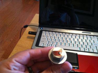

My Latest...
Doesn't show up real well, but the top of it's polished. That's the reflection of my ceiling fan in it...
I stopped at a local CNC machine shop last Friday and talked to them about having these manufactured on a larger scale. I'm still waiting on the quote from them, but from their preliminary "guess"timate on costs, I'm pretty sure I'll be going through with it.

Its a perfect job for a single spindle CNC Swiss style turning machine with live tooling..

Not surprised, look for a small shop.
I can get it quoted here but machine rate is around $75-$150 an hour.
If you can bump up the volume the price will drop.
CNC work costs more.
Maybe change the design.... start with hex stock instead of round.
Then it becomes a screw machine part.... a brown and sharp could do it.
You might find a shop rate closer to $45/$50 a hour.
If you switch to mild steel and get it plated the price will also drop, easier to produce.
Just a few ideas from a old Machinist.

Thanks for the input!
That was a relatively small shop. I don't think they've got any more than about 10 people working there. I do believe their rate is about $75/hr though...
There's a couple other local places that I found today. I'm hoping at least one of them will be able to do it for a reasonably cheap price. I'll try stopping in to one of them tomorrow on the way home.
Changing the design is really not much of an option for me. The design is really one of the highest selling points. There was guy on the mustang forums making them out of hex stock. While functional, they looked pretty hideous. I wanted the functionality of it, but at the same time, I wanted something that I'd be proud to display smack-dab in the middle of my engine bay.
The other big selling point is the fact that it's stainless. People hear "stainless" (most notably, Cobra owners) and they just HAVE to have it. Plus, switching to steel wouldn't yield very much of a price break, and then you'd have to factor in the price of the plating...
I really do appreciate the input though man. Thanks! :)
if you can get the price down to the 30 or 40 you had wanted, i would probably buy one. they look really cool. machining work like that really interests me.
