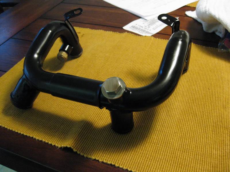

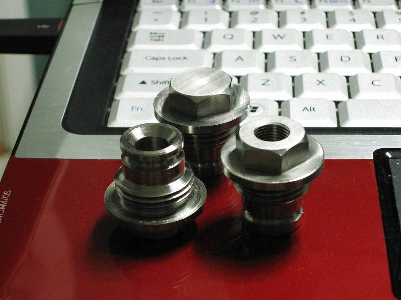

My "custom" coolant crossover cap

Do you have a pic of one twisted onto the tube? I'd like to see what one does look like put on.
yeah.

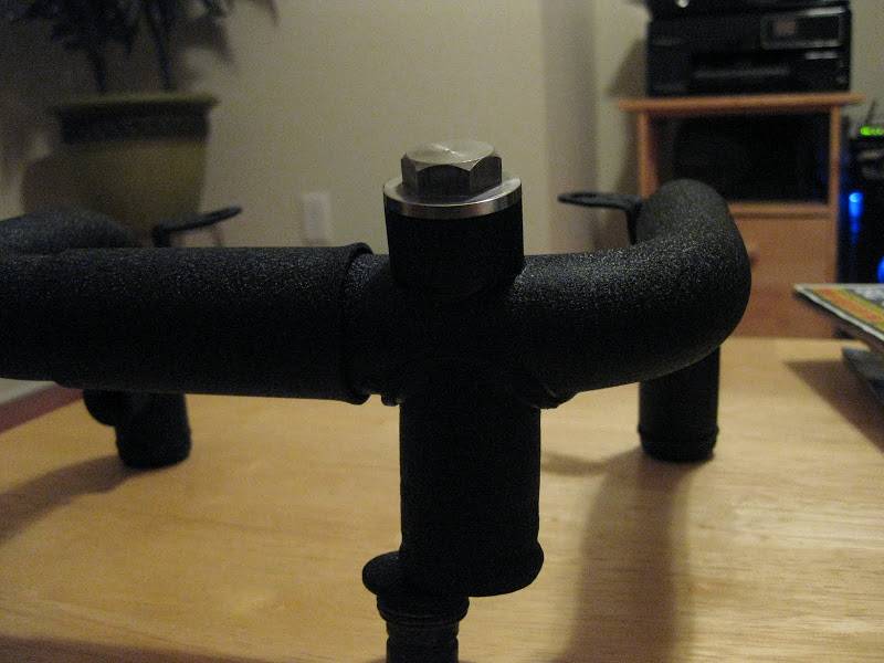

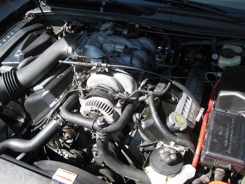

Here's some pictures of one of them installed in a wrinkle black powdercoated crossover tube....

I understand how you want to keep the design, it could still be blanked out on a screw machine, the hex put on as a secondary operation on a VMC.
I don't know if your volume is there to do it, it would be a min of 200 pcs. to bring the price down.
I agree the cobra crowd will want the S.S. cap, but I wonder if a mild steel with black oxide plating would sell to the Mark crowd.
Mild steel would bring the price down, no doubt about it.

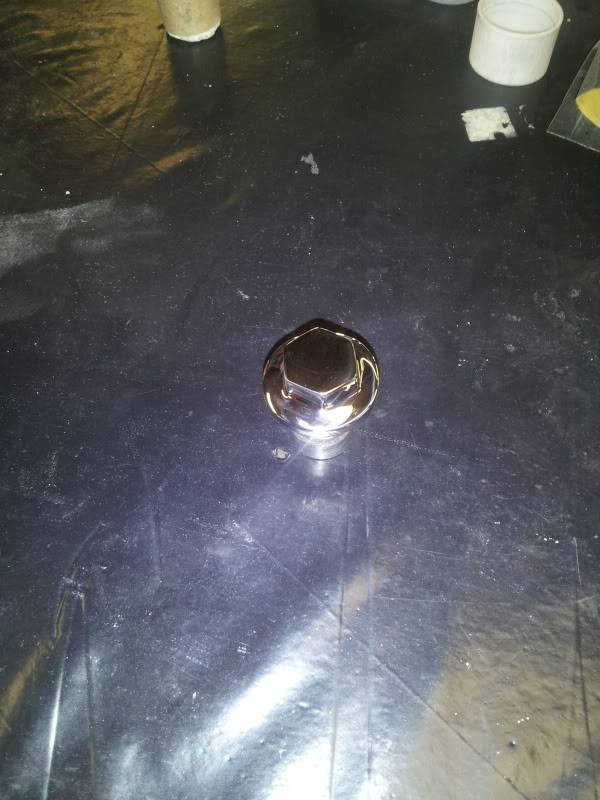

From this
To this
Can I be in the super shiny crossover cap club now???

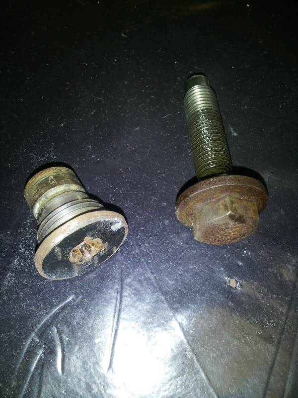

No. You can be in the "shiny crossover cap that's gonna rust and give you the same seizing problems as the stock cap" club. They're closely affiliated, though.

Here's the one on my car, Terry. The crossover tube is powdercoated wrinkle black...
This is one in a stock-looking matte black crossover tube for a guy on LOD...
Mine don't seize, I don't use water in my coolant ..and anti -seize helps
