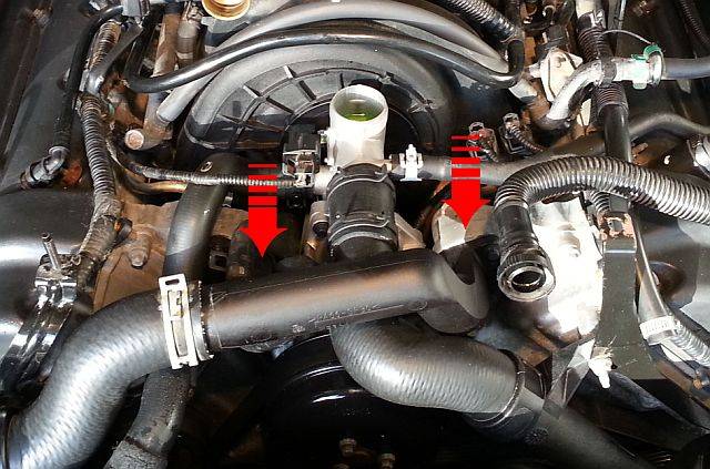

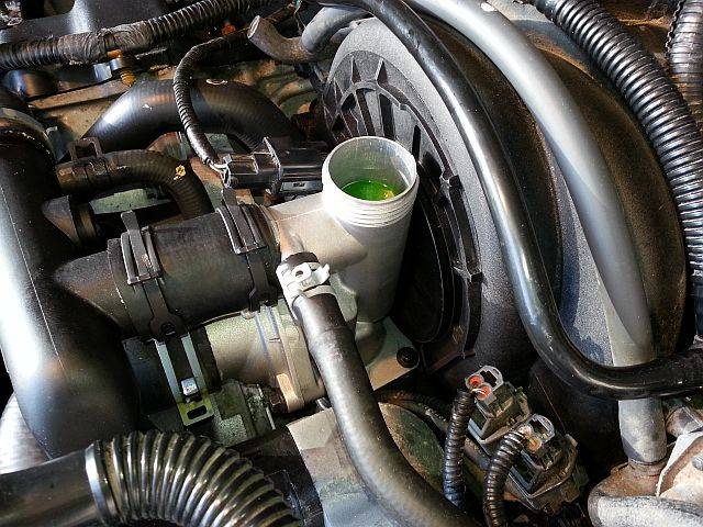

Just want to point out that if your going to get into the LS plumbing, <br>
there is a JAGUAR T-stat housing available for the 1ST GEN, all Aluminum, cheaper and direct fit.
ÜRO PARTS ~ p/n NCE2247ADKIT = Jaguar Aluminum Thermostat housing (upgrade direct fit to 1st GEN LS)
~ Jag housing comes with new rubber O-rings, use those provided.
~ Use Lincoln LS brand thermostat not the Jaguar thermostat (different release pressure)
see my thread: Re&Re - Jag Aluminum Upgraded Thermostat housing - GEN 1 V8
I'd throw a new Degas bottle in it while your at it! >> Re&Re - OEM Degas Bottle - GEN 1 V8
Yours will have hairline cracks in it, telling you now! (unless already replaced)
Also, Re&RE - OEM Coolant Outlet Pipe - GEN 1 V8
