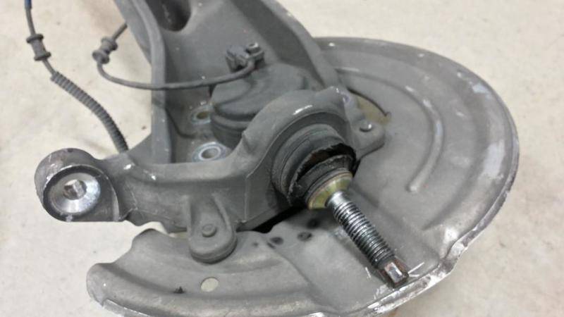

these off of ebay -
Not sure about those, hopefully, they're good! I went through a bunch of Mevotech $75 knuckles and their ball joints all lasted around 6 months. That's some scary reliability! I think I ended up doing two on each side before I blasted Moog problem solver ball joints into them.
meh, i'll run them and see how they last. i do simple commutes with the occasional
road trip, so this car doesnt get beat on in the least bit.
if i get 20k - 30k miles out of them, i'm happy.

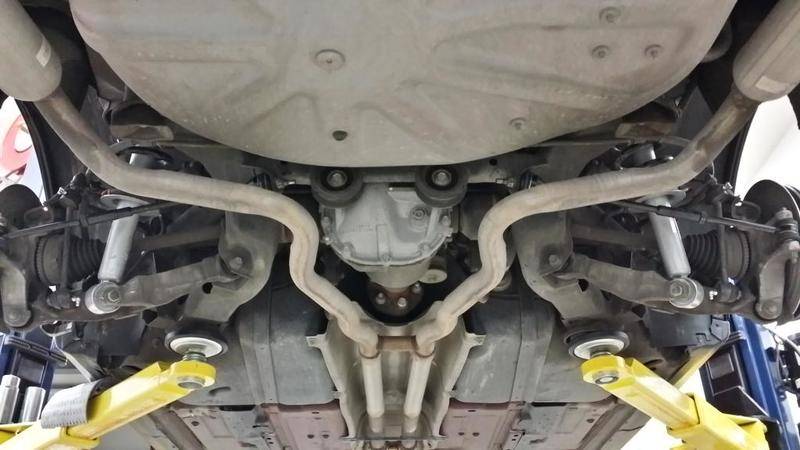

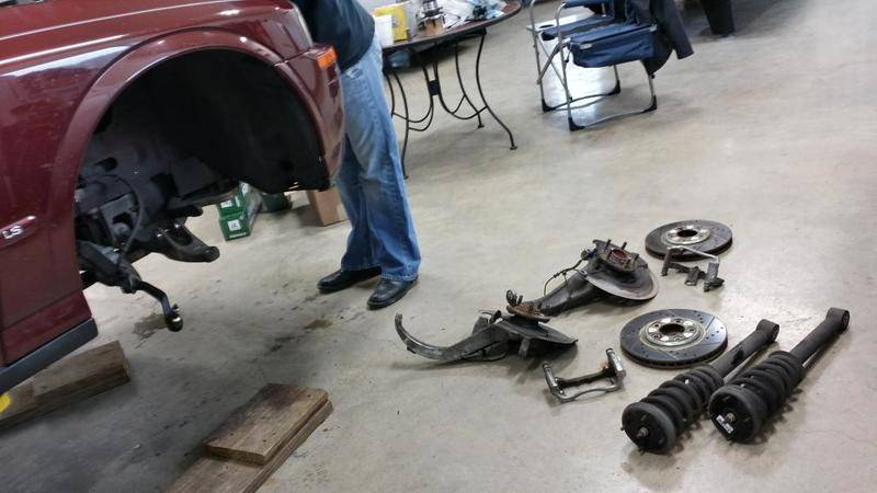

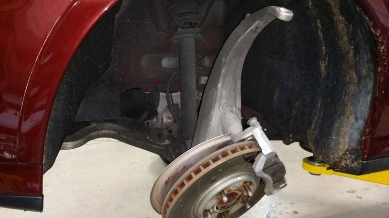

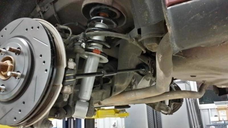

...so just a few pics of the work we did over the wknd. the driver side
rear caliper was one silly beotch.

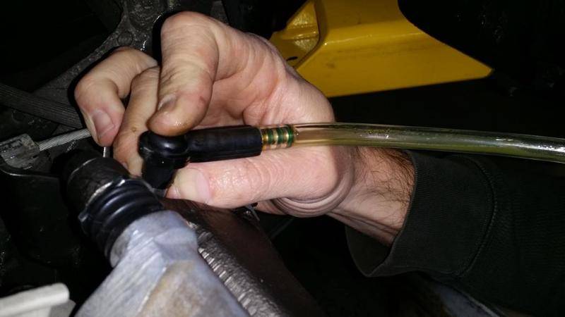

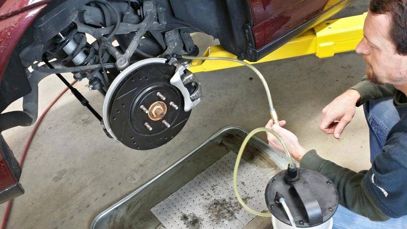

vacuum speed bleed !
I forgot...... What shocks are those? Is that the Jaguar shock/spring combo??
