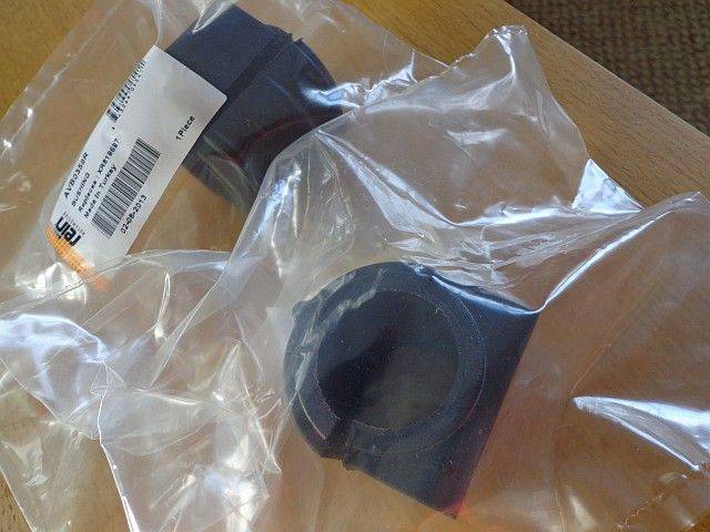

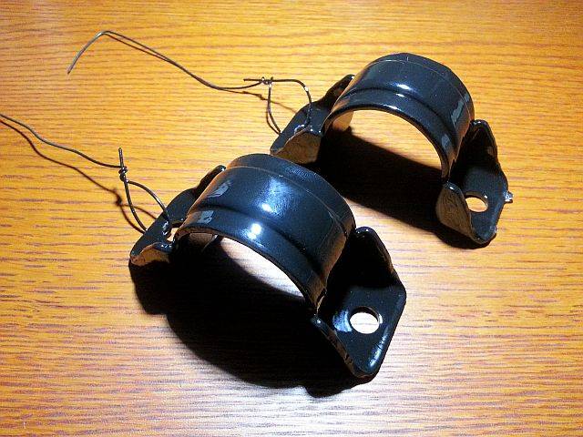

I've got a set of those Jaguar bushings, bought at your suggestion, here at the house. I have a Getrag 2001 sport with the larger diam sway bar to install them on. I got the ES bushings and some collars for this 2000 non-spoort with a Gen 2 sway bar. It's almost out and I wont be disconnecting any AC lines. I just dont want to be running a dremel under there in those tight quarters. Just dont trust me or the tool. What's with the wire on the brackets?

... What's with the wire on the brackets?
The wiring was used to hang them up while painting. They were soda blasted as well.

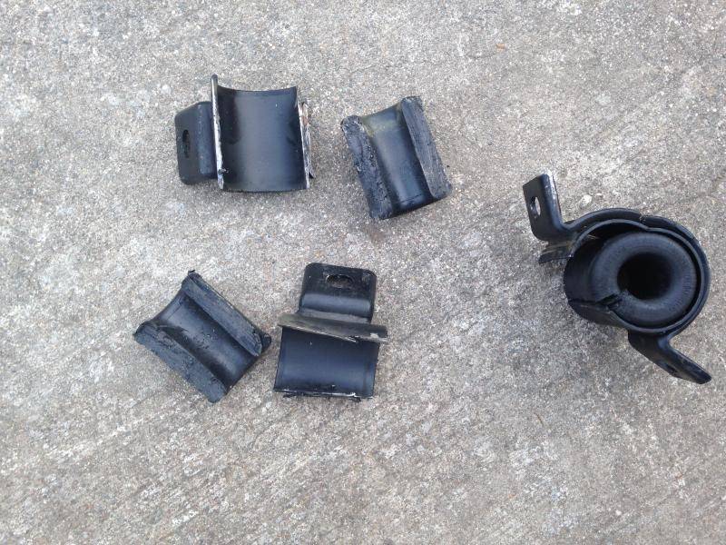

So I had to use a dremel under the car after all. I could not get that sway bar with bushings and brackets on it out of the car. Removed left spring/shock and pushed knuckle way over but it ended up that right side bush/bkt would not fit by all it's obstructions. So I dremelled off the left side while sitting in a chair. Then I had to get down on the crawler and dremel off the right side. It was difficult and a bit scary under there with sparks flying all over trying to keep the dremel in place and fingers out of the way and eyes protected. It was as hairy an experience as I feared it would be. But it's done. And if I EVER have to do this again, I will bite the dremel bullet and follow Deaconblue's plan to the letter. It will be quicker. It still remains for me to install the ES bushings and the hold tight collars and put the thing back together including a new PS pressure hose whose nipple I damaged sadly. BTW - $18.26 at rockauto, $254 at FPG. What gives? Maybe I'll find out...? Also gonna flush the PS system and the hydraulic fan system while I'm under there. Put in new Mercon 5. Here's some showing the fruits of my labor. On the left is what's left of the driver side stuff. It was easy to get to so I went postal on it. On the right is the passenger side. Tougher to get to underneath and a bigger PIA to force off the sway bar. Last is a before and after of the single dremel blade I used to destroy the driver side bushing/bracket.

I'm kidding ... glad you got it out, work smart not hard. Cut it out. Every good man should own a sawzall also. Medium sized air compressor with associated air tools don't hurt either.
Good luck with the rest, couple of drops of oil on the bolts as you reinstall them would smooth them in. Try and clean any build up off the bar where the bushings sit and a dab of crease around it wouldn't hurt any. The PS brackets and bushings are serviceable I recall. I removed mine and replaced with the Jaguar Rein bushings.

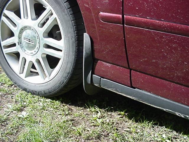

Mud flaps !!
Washed before i left but,,,,puddles on the way out the drive to the garage showed why i need them..
Will wash and see how they work.
Lot's of advantages living out in the woods but a 1/2 mile long dirt road aint one of them ! :)
Mud flaps !!
They won't do much of anything about keeping mud and water off. They will, however, help keep rock impacts from damaging the paint.
I guess any help is a plus eh ???
it was oem or large AM that would look like gull wings flappin in the breeze !! LOL

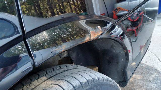

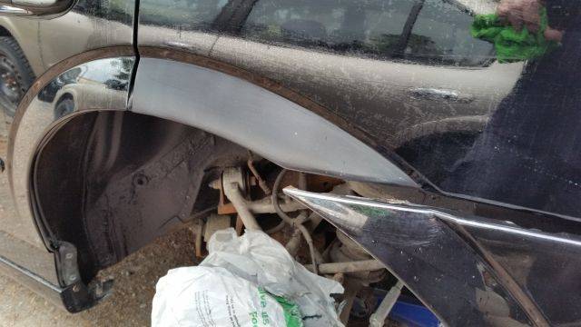

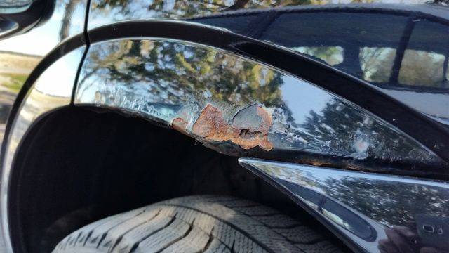

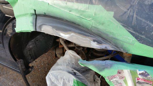

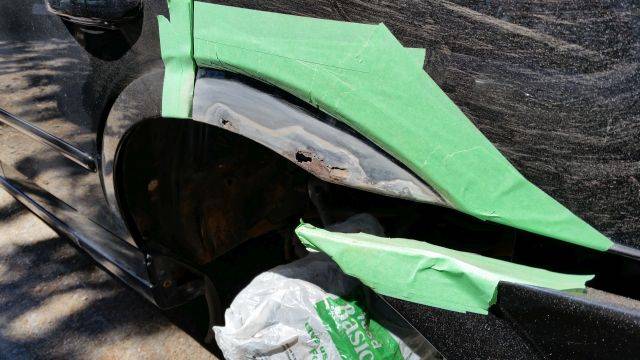

Decided to do a little DIY bodywork, get this 04 LSE cleaned up a bit.
Started raining a little, will have to get back to it some other day.
Have a couple small spots of corrosion on the drivers side aluminum front lower fender where the door begins.
