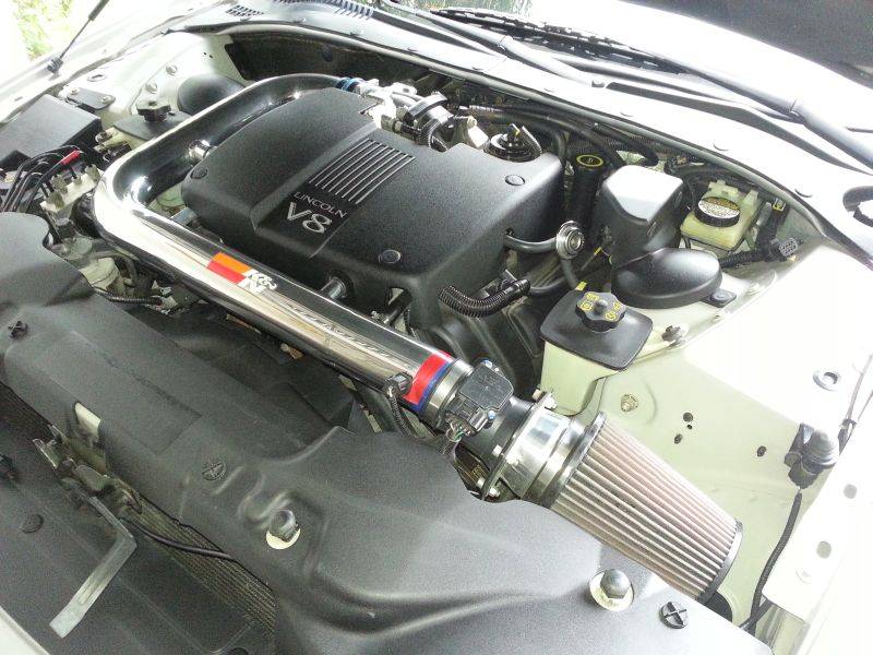

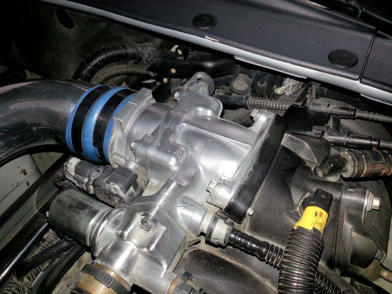

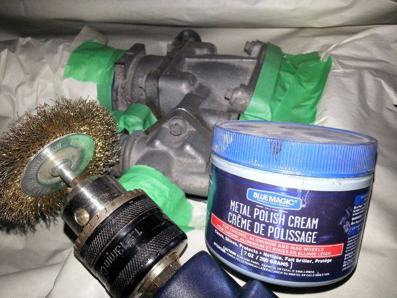

More underhood cleaning today.

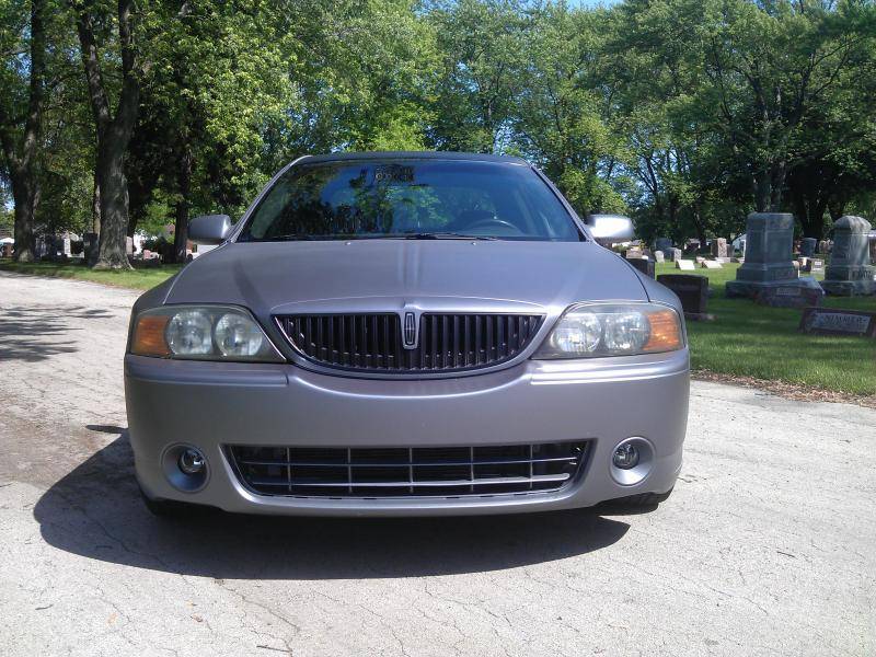

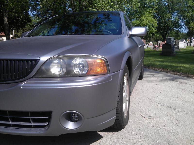

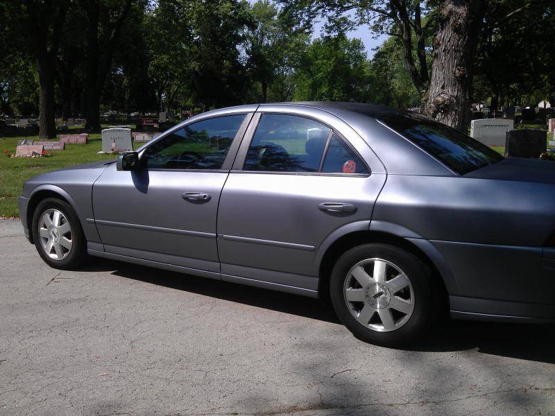

I haven't had the time or many windows of good weather opportunities, so I only have a few shots that I took with my camera phone just pulling over on the way somewhere. I still have some touch up to do, peeling in areas and when it is cure enough to have tape on it black out the grille in the bumper. The color is extremely dependant on the lighting. You will notice while one mirror in the shade is dark and the other is very bright. The color will go from a very dark gray to a medium gray to a bright silver.IMG_20130624_154414.jpgIMG_20130624_154404.jpgIMG_20130624_154351.jpg
Dan Ro looks great man. We need better photos, though!
But it looks like you did a great job on the spraying etc. Can't wait to see more.

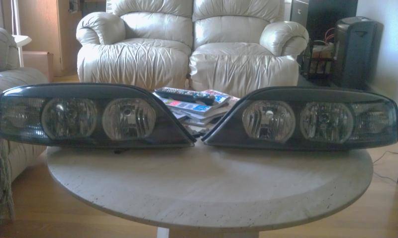

I'd put them on the same level as the stock 06's. Maybe a little better just because they're different.

I haven't had the time or many windows of good weather opportunities, so I only have a few shots that I took with my camera phone just pulling over on the way somewhere. I still have some touch up to do, peeling in areas and when it is cure enough to have tape on it black out the grille in the bumper. The color is extremely dependant on the lighting. You will notice while one mirror in the shade is dark and the other is very bright. The color will go from a very dark gray to a medium gray to a bright silver.View attachment 828459870View attachment 828459871View attachment 828459872
Very bad a$$!
get some more pics and start a thread..I want details!!!! good job!

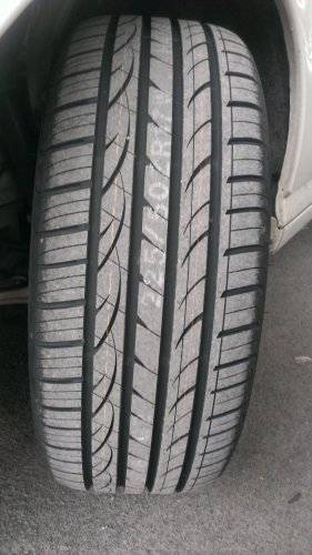

Got new tires. Hankook Ventus S1 Noble 2, name is horrible and way to long but the tire is pretty dang awesome.
They are a new tire so not many reviews exist for them. However, they had a pretty great UTQG rating of 500,AA,A and they were cheap, and came with a rebate. $420 total for all four, and that includes shipping and the rebate. So far so good, much much better than my terrible Goodyear LS II's.

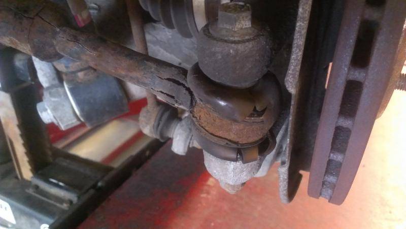

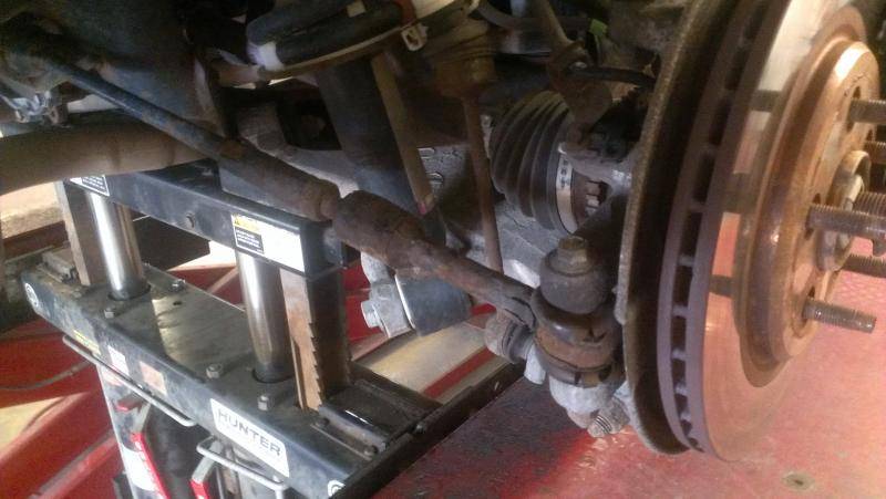

Anyway while my car was on the rack I took the opportunity to check out my suspension components and sure enough, rear toe/stabilizer or the 238 names for it needs replaced.
The passenger side is long gone, and the drivers side hasn't torn yet but its imminent. I read this entire thread http://www.lincolnvscadillac.com/forum/showthread.php?75683-Rear-Toe-Link-Tie-Rod-Lateral-Bar-options-other-then-ford&highlight=rear+toe+links and it gave me a lot of help but I still need some input. On the last page a member links a set of Stabilizer and Sway bar links for a good price from ebay, however the part manufacture is unknown. Another member states they are deutsche parts, if that is the case than no thank you. They are not synonymous with quality. They are interesting because the include the "compression sleeve" like the OEM parts which are very hard to find. Also, to add to my woes, a jag version is also submitted that is a direct fit but does not have the compression sleeves, some users don't report any tangible difference so it seems acceptable and build quality looks great. Any feedback on this would be greatly appreciated but please provide any relevant info in Kumba's thread linked above to keep all the good info in that one very good thread.

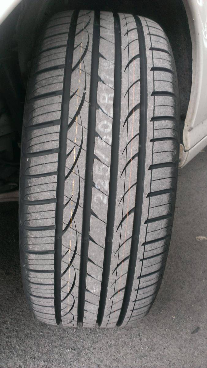

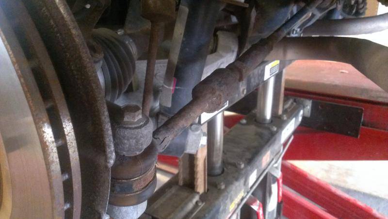

View attachment 828459923View attachment 828459924View attachment 828459925

I replaced all upper control arm from tasca motorcraft (Jaguar stamped on them) brand. Replace front and rear stabilizer bar links Moog brand from rockauto along withfront tie rods with Moog brand. The rear toe links were replaced with deeza parts also from rock auto. Same day I got it back, I fitted it with bfg g force 235 / 45 Zr 17 94y tires. The guy that took care of alignment and balancing was gone for the day. The owner guaranteed 200 miles of driving during the weekend anything went wrong he would replace any and all damage (had him sign the receipt stating that) ended up driving about 180 miles that weekend. The tires and alignment held up, my mechanic did an awesome job replacing the parts. Have driven about 2500 miles since. Tires look and feel good. Took some pics of the deeza toe links as they are now.
Driver side
Passenger side
That second pic on the driver side I need to take back. As far as performance its way better. Better than out the dealer parts I really wouldn't know. The stabilizer bars were gone when I bought the car tie rods were getting there. I figured I'd save up for tires and suspension parts.

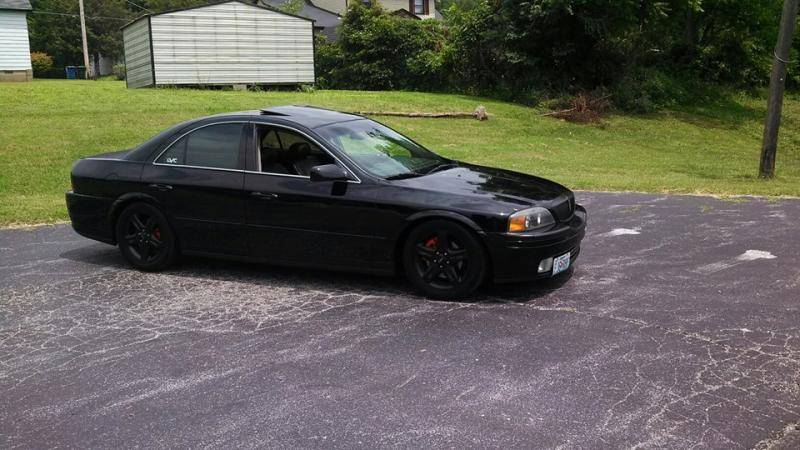

only chrome left is around the windows,and that will be next to do. im liking it.

Yeah, Hankook's, since I swapped out to some of them Hankook, I simply get not get any squawking noises from the rears, I can feel them lite up but more traction than noise. Along with the 19" wheels, thing rides on rails.

Yeah Hankook is really turning into quite the contender in the tire world. Everyone I know that has them has no complaints and they have a 97% rating on consumer reports. If these are as good as the rest of Hankook's reputation I'll most likely be a customer for life.
