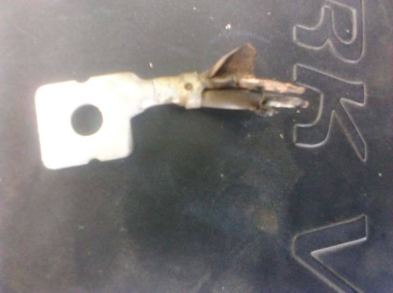

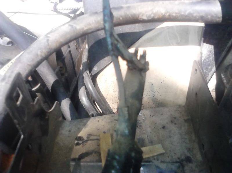

this the cable coming from the battery
this is the cable coming from the fuse block to injector line
this is the other half of the cable to the injector line
can this be fixed or am i looking to buy a complete harness...HELP ANYMONE.....
ouch. but not the end of the world. my car doesn't even have those cables anymore. they heave been replaced with new 4 gauge cabling. get some from a stereo shop, cut it the same length, put some lugs on the ends, and reinstall.
but not until you find out what shorted out.

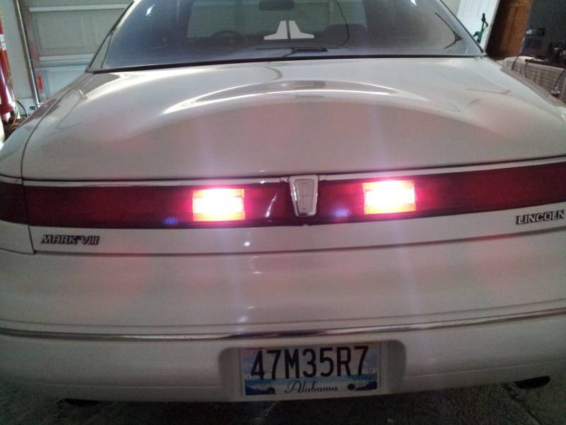

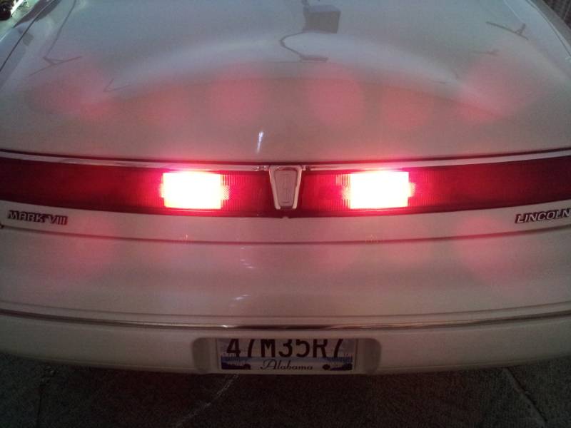

I just installed these a little bit ago. Took maybe 5 min and although it's daylight, I can see a big difference inside the garage. The light is super bright white and not yellowy.

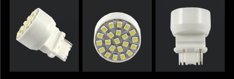

Reverse lights with 22 SMD LED's in each light.
These are the normal bulbs and were hot as hell when I pulled them, using a rag. I kept it in reverse while doing it because the SMD's go by polarity + / -

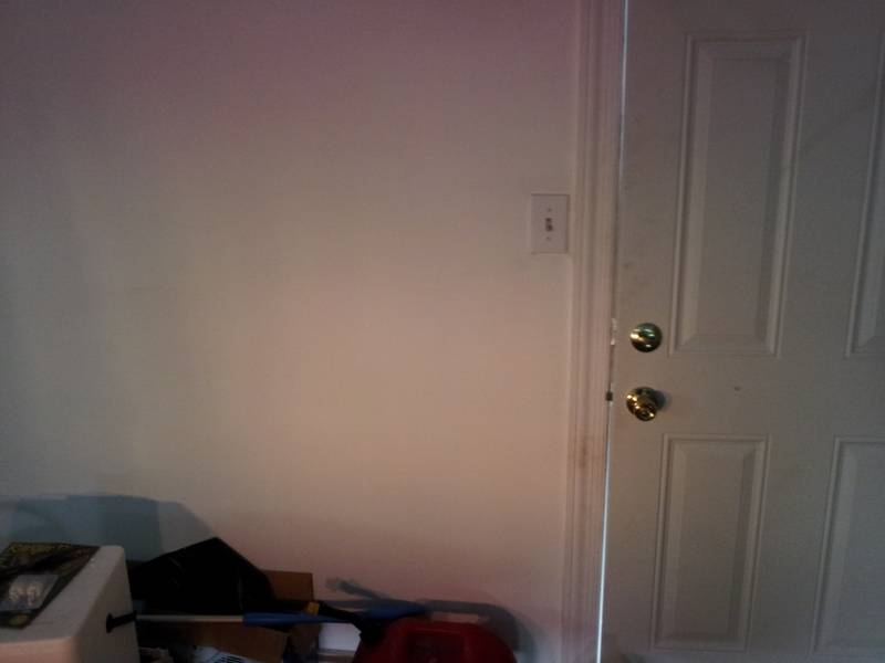

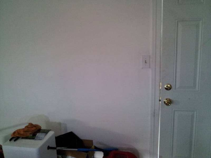

Now the look on the wall behind the car with normal bulbs.
SMD LED's installed
Now the look on the wall behind the car. Made it a lot whiter and these bulbs shoot straight out instead of all around. Also, very very minimal heat, if any.
Not too bad for $14.00 to the door and supposed to be good for 80,000 hours. I highly doubt the car will ever see 80,000 hours of being in reverse. The pics were taken by phone but in person, they look much better and have that new car LED look.

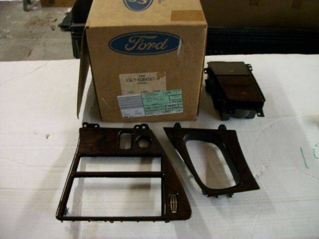

Bought something else to go in my closet today. It's shipping out today so I have no good pics of it at the moment but it should be here Mon or Tue.
Never installed, NOS woodgrain stereo, EATC bezel, shifter bezel and ashtray / cup holder assembly, all in mint condition. Also bought another new front Motorcraft air shock to put away. Going for the other side in a few weeks. I really need to stop spending so much. :rolleyes: If I was married, I could hear it now.... :blah::blah: in one ear and out the other.

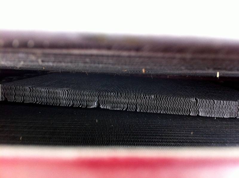

After last weekend's JMOD on my 96, today was the day I intended to install a transmission cooler.
Took the cowling off under the hood and started looking at the connections at the radiator. They looked a bit odd, they definately weren't stock. Did a little more investigating and noticed this...
There's already a trans cooler installed. Unfortunately, whoever installed it put it between the radiator and the AC condenser. I can't imagine it's doing much good sitting between those two HOT items!
So, change of plans. Gotta get that out of there and relocated. Geesh!
