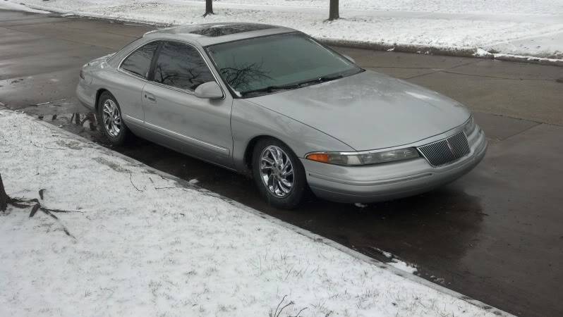

Not a damn thing. I did get bicycle tires for the front of the silver bullet today though. They are no wider than my shoe. :D

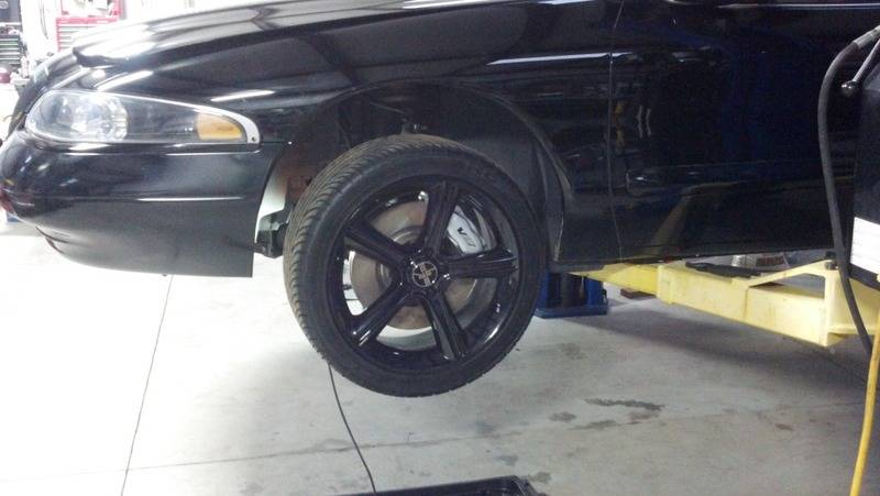

dns , you'll need to shave the edge of the Mark8 brake lines fitting where it touches the caliper. Just hold the hose on the caliper as if trying to bolt it on and you'll see that the hole needs to be moved .. so shave the edge of the block a bit
I used an angle grinder with a sanding disk
And use NEW copper washers on each side of the hose when bolting it up with the banjo bolt for that caliper
Also make sure you're placing the caliper on the proper side of the car, or you'll have a fail time of bleeding the system
