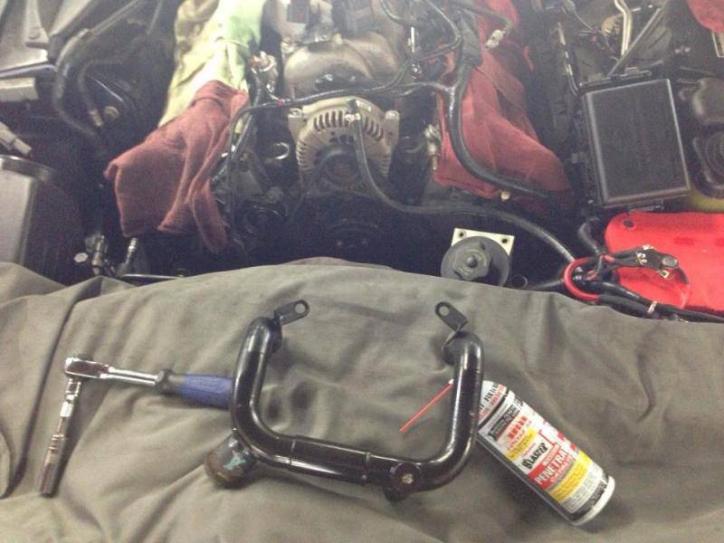

I did as everyone suggested and started the day with a trip to Autozone for some PB Blaster so the crossover tube wouldn't argue with me. Boy, that stuff is amazing!!! It took me less than five minutes to remove and the tubes in the engine looked better than the connections for the hoses by far. Huge day tomorrow as all the goodies are finished at the powder coaters. I spent all day today cleaning everything that was exposed by removing the hood and valve covers. Had the chance to put protectant on all the plastic and rubber, particularly that windshield cowl area that tends to leak. Also got to the rear heater hoses and covered the new ones with some new flex shield that I finished with heat shrink. Can't wait to have her back together and in her own garage again. I think it's going to be amazing!!!!! :D

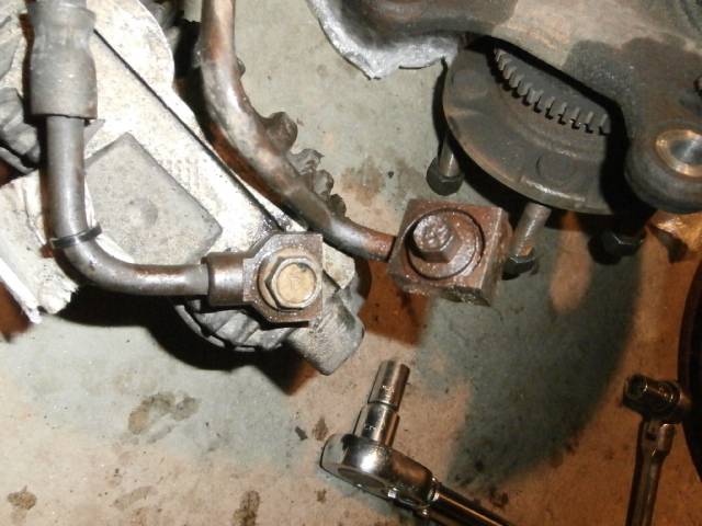

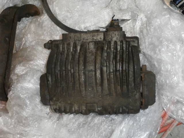

received my '94 PBR Corvette calipers in the mail; time to clean then paint

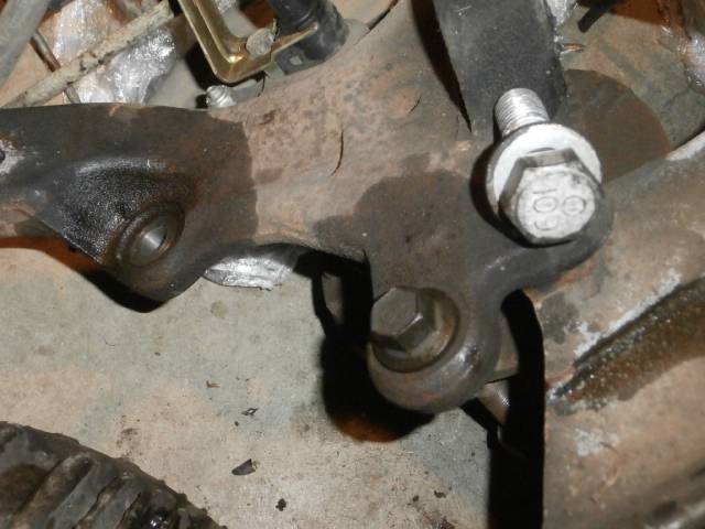

started playing around to see if they will work; the vette bracket holes line up w/ the Mark spindle as forecast, also as forecast the bracket bolts are not a match
the vettes are 13/16 and the Marks are 15mm
--I'd rather NOT spend more money for Cobra brackets, since I paid for the vette brackets. But I guess it's either that, machine/bore out the spindle holes, or come up w/ a spacer so I can use the 15mm bolts in the 13/16 brackets?

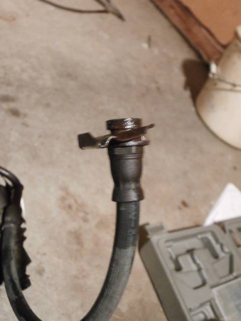

-also as forecast by Superfyre, the banjos are not a match:
1/2'' for the vette, 10mm for the Mark
not sure what to do with the banjo bolt mismatch, open to suggestions
....this is the open end on the vette brake line
maybe splice into the Mark VIII line?
