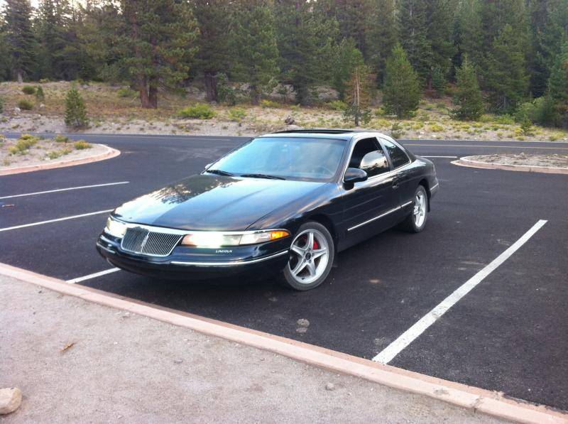

Over the weekend, put a good wash and wax on the ol' girl.

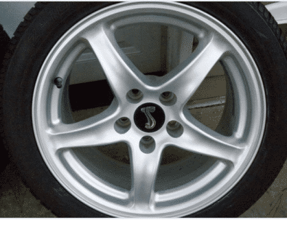

I'd save that work for when you've got bigger brakes and the wheels you want for the 4.5s
Since it looks like you're a salvager, hunt down a C4 vette. You could probably buy the parts pretty cheap new thou. And since its off the car - paint it
good idea on the calipers, I may go that direction...BUT
that bolt patern is 5x4.75''??? so are you saying use C4 calipers, and a rotor from...???
btw, I've already got the wheels and tires (5 of 'em) and I'm trying to minimize my labor- the fix it list is way too long on both cars
I 'think' I've read enough about the brake debate to where I'm convinced I'll survive w/ factory brakes...I'm certain there is disagreement on that

I found all 4 at a salvage yard from an '84 vette for $25 each...rotors are available also...BUT, those lug patterns are 4.75''. right? so with vette calipers, what rotor is used for 4.5'' Cobra wheels? this is starting to seem like one of those ideas/mods that's more work and trouble than it's worth..I've yet to have trouble stopping, but then again-I don't race
No. You just use cobra rotors. You are over complicating this. Put on cobra rotors. Bolt on vette calipers. Done.

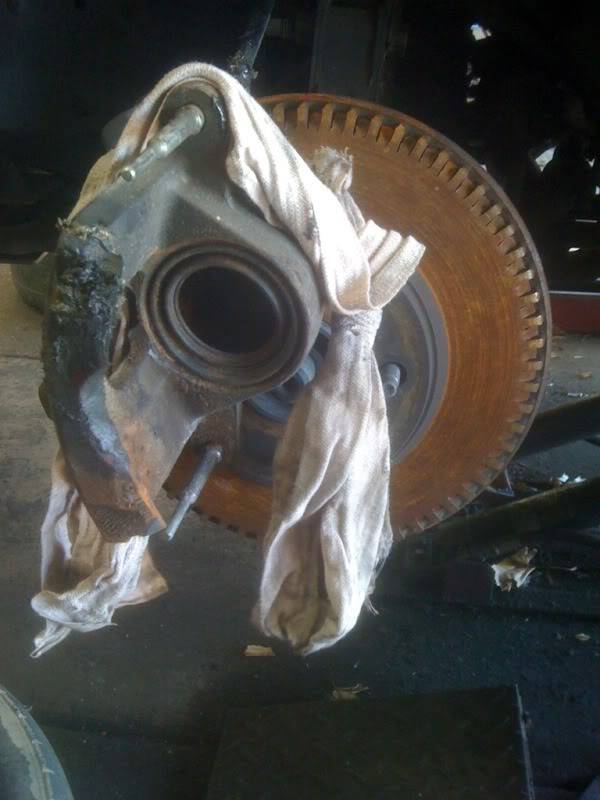

And this is why I cringe when I hear some of you want to do the work yourself...
This guy had actually tried to tie the brakes together with a bandage
So if you don't KNOW what you're doing, just leave it alone

-----well, I am not in tech school and no one is gonna come walk me through it... I'm not a professional mechanic, and may not even be a top-notch shade tree mechanic, I would never do THAT BS in the picture
swapping the whole rotor/caliper/hub assemblies seems simple enough for me to do...2, maybe 3 times :shifty:

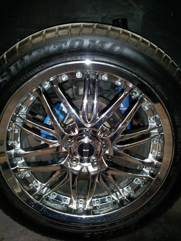

Finally colored my rear brakes. Relubed everything since I had it apart
I want larger rear brakes now, they look so tiny compared to the fronts ,and it would be sweet if they could be relocated to leading instead of trailing
