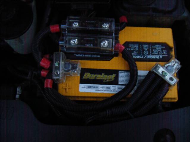

Shoot pics of ur big 3 setup due that i will b doing it in 2 weeks.
Just a quick pic of how it's wired up. Lots of wires and very little space.
All ofc 4awg
Pure copper ring terminals
Used factory chassis ground behind drivers side headlight
Engine ground is behind the ps resv bracket
Alt to 140a fuse > fuse to battery
Then of course the power wire for the amp with another 140 anl.
Retained all the factory power and grounds. Quite the cluster****.

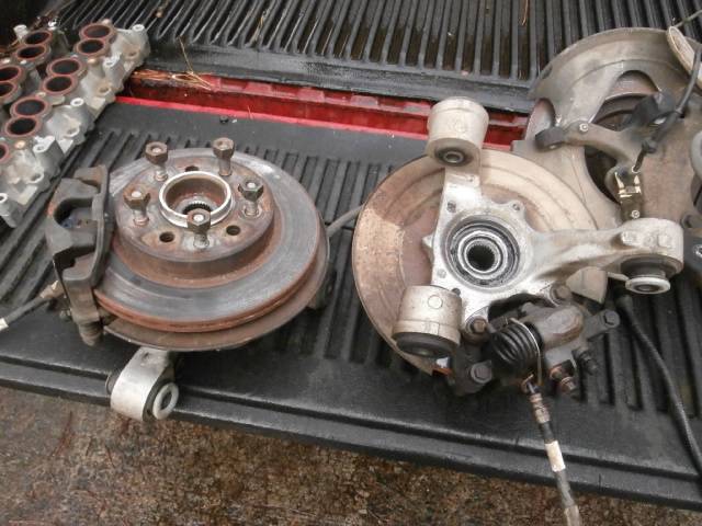

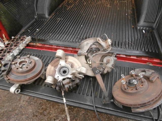

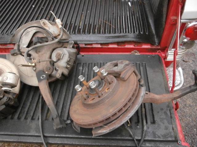

it wasn't today, but I got these awhile back...4.5'' bolt patterns
now I haven't worked on the suspension before, but I'm hoping this will be a simple remove and replace job...when I have the time
I'd save that work for when you've got bigger brakes and the wheels you want for the 4.5s
Since it looks like you're a salvager, hunt down a C4 vette. You could probably buy the parts pretty cheap new thou. And since its off the car - paint it
