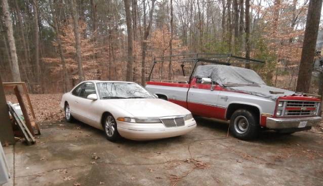

the white '96 (project car) just passed emissions!
- time to get to triage work:
