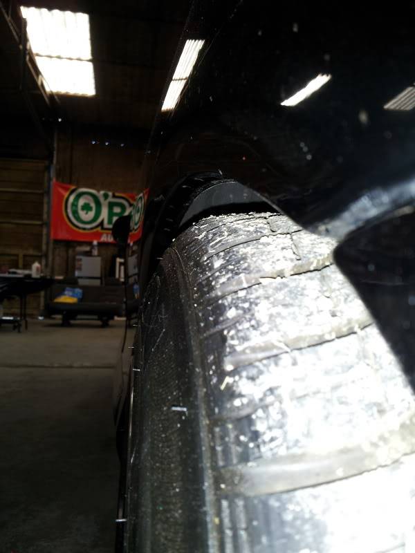

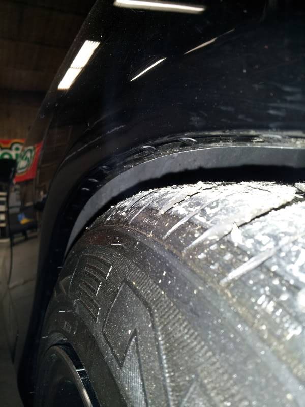

To roll or shave, machine hub spacing or new wheels???
That is the question
Damn Sapper, you're tires are really stuck out there. Now I see why you might be wanting to sell them to someone that owns a Mustang. I don't think you're going to be able to fix that and make it look pretty and you still don't have the tires you want yet. Get those sold dude and get the other offset so you can get the wider tires you want and maybe very little rolling, if any. I didn't realize they were out that far.

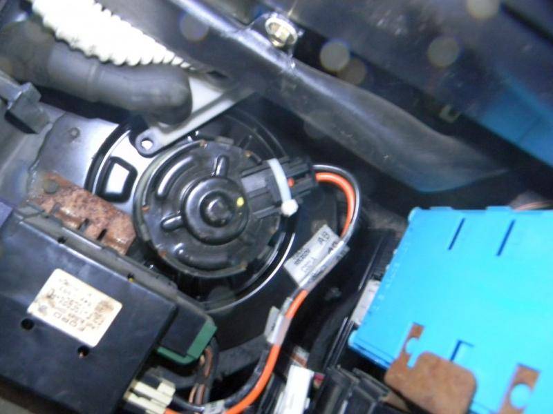

Got in the car today and, no blower motor, figures! Checked all fuses (all good) and I do have power to the black/orange wire (checked with meter). I can only assume this means motor finally took a crap. Can this be replaced without pulling the dash? It looks like with a little bit of moving things around it should come out through the glove box opening. Could this be possible? Could it really be that simple?
Have you tried all this first?
[url]http://www.lincolnvscadillac.com/tech/lincoln-mark-viii/blower-motor-repair/index.htm[/URL]

No...I didn't try all that, but I'm going out there right now to give it a try! I have to try everything you guy's suggest 1st before anything else, just because you guy's seem to know these cars better then anyone else! I didn't have intermittent contact. It worked Friday and didn't Sunday (no drive on Saturday). It didn't make any noises like it was getting ready to go out. Just nothing! My connector seems to be nice and tight (had to wrestle around with it to get it off) to check for voltage.

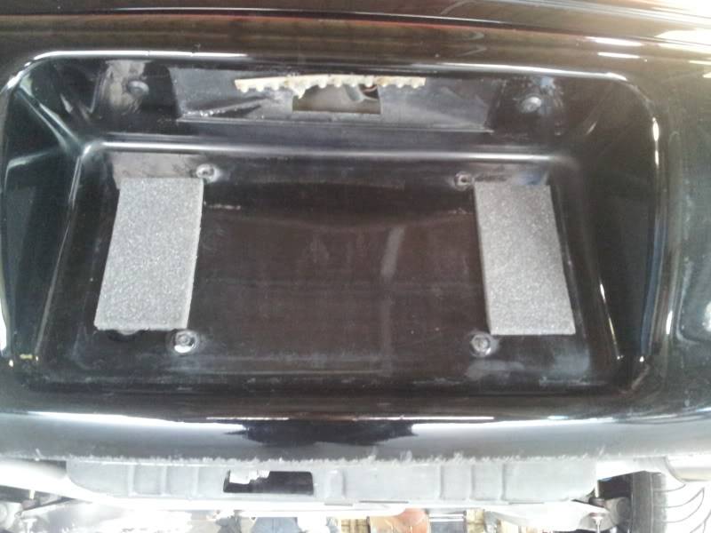

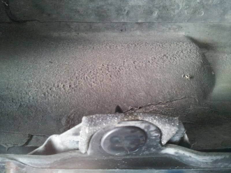

I've been wanting to take care of rattles in the rear caused by the sub.. so
This is the foam strip you'd get for insulation around the edge of a window unit AC. Cut in little squares and stuck to the bottom side of the body , then put the push pin back thru.
And behind the license plate, and also a thin strip on the backside of the plates frame
No more rattles back there now ;)
Blower Motor!

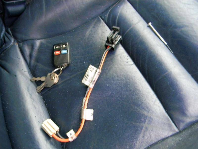

TERRY MAN!...I LOVE YOU!...This worker perfectly! Not sure why! (I really didn't think this would work)...Did everything just like posted (pics included). It was ice raining when I tried this.
Dam....you are (BAD A$$!)
I was planning on a new blower motor and the time to do it. but with this fix....it worked perfectly!!!! The blower, blow's like a wind tunnel!
I removed the wire because of the ice rain, you can see on the seat (and took it into a heated environment).
I'm gonna give you a BIG frick'n kiss when I meet you in person!!!
Chalk up another fix to the GOOD people here on LVC!!!!
I have heat again!!! total cost....NOTH'N!

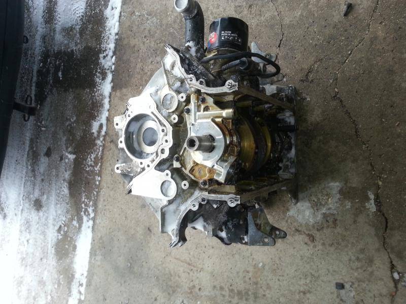

got my 98 trans finished last night, started her today and put in 11 qt's of Mercon V
runs and moves, but havent gotten on the streets yet. damn snow....

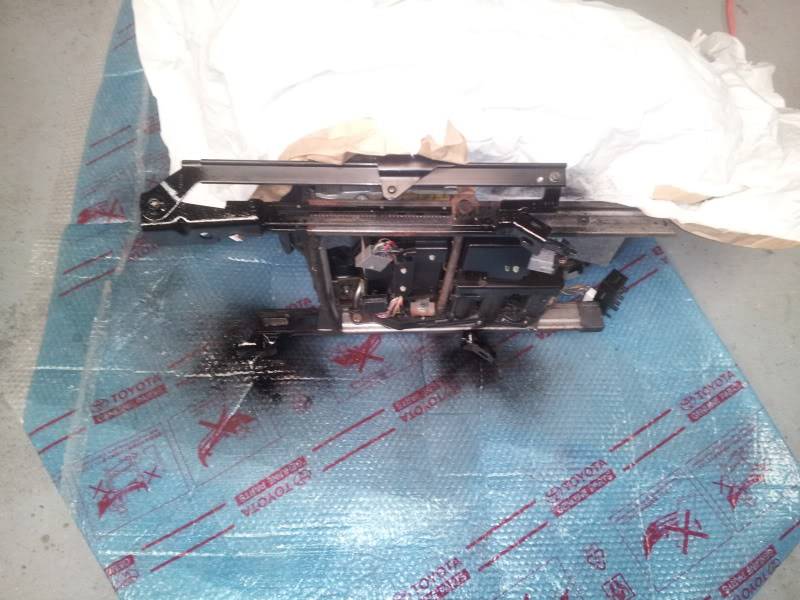

I pull my seats out when I vacuum, tired of seeing the little square rust spots under the anchor points... and STILL sucking coffee out of the carpet from the last owner
