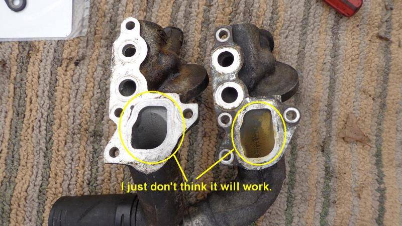

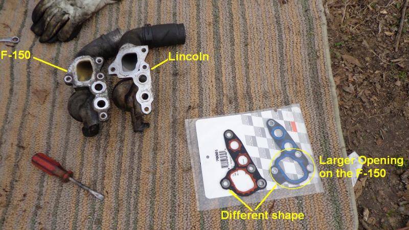

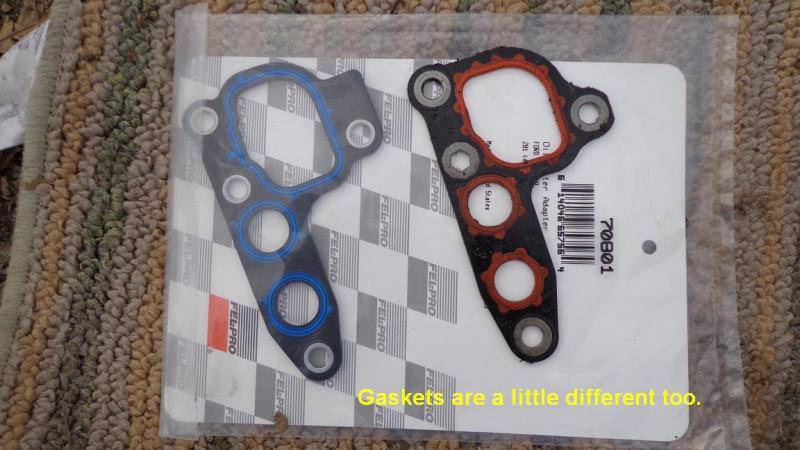

Well. Here's the pics:
I just don't think they're close enough to risk putting the F-150 part on the car. It may work, but it might leak. That was a monster getting that sucker out. I certainly don't want to have to do it again. So it has to be done right with the right part.
Glued all the tabs back together with Gorilla glue, hope this'll hold it for a while.
Lay the gaskets on top of one another, that'll give you the answer you want
But for the record, I've used both style gaskets on Marks and had trouble from neither
Hmmmm. I think I may give it a shot. I'm just concerned about the different shape of the opening and whether or not the gasket will seal properly. But if you've used that style gasket and it worked, then maybe it will be fine. There's only one way to find out.
