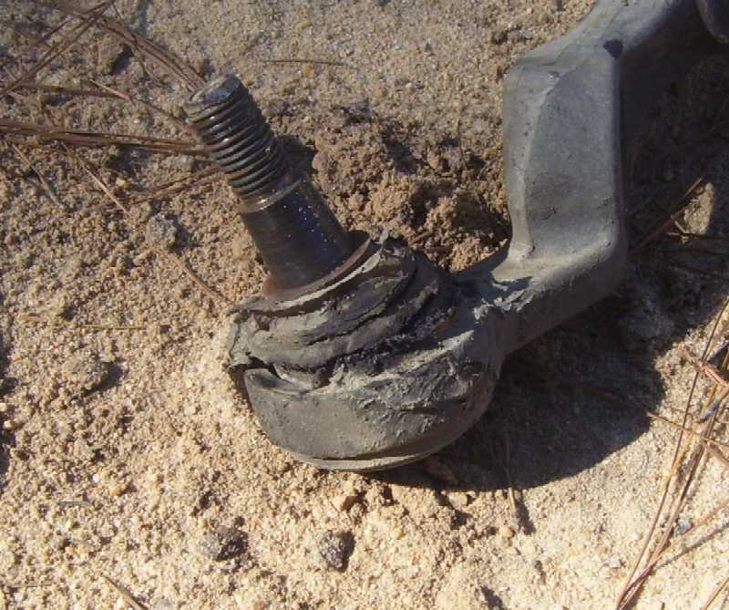

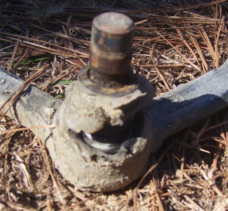

Grrrrr! Just finished installing the passenger's side front UCA, LCA, new air spring/shock, sway bar link, and outer tie rod end. Took all day! That was a job and a half!!! And I still have to do the driver's side. And to top it all off, the d/s outside door handle broke!!! And the front end is badly out of alignment. But I expected that. But one good thing happened, I got my HID's for my '96 in the mail today! Yay! I'll be able to see at night...maybe...

I don't doubt it. But I've never replaced all that stuff on a Mark before. And the car was on jack stands in my driveway, and the lower ball joint didn't want to come out, and that nut on the back side of the shock tower for the UCA was a PITA to get to...etc, yadda yadda. Plus I had to go to the parts store to get a 24mm socket and wrench because I didn't have one. And of course nothing went as planned. And there was much beer involved:D However, I learned a lot, so the other side won't take as long...hopefully.

Hey! Ya think my ball joints were shot to sh!t?!
