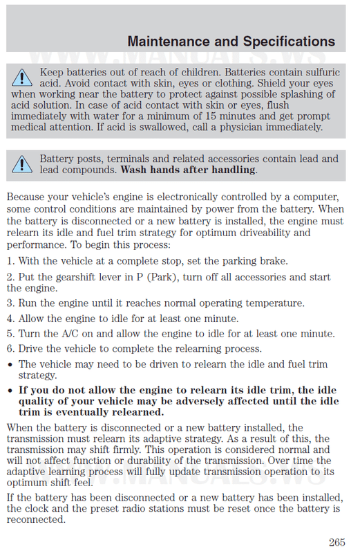

For anyone curious, this is what's being discussed: (from the '04 manual)
However, that's just for resetting the proper idle speed. It has nothing to do with the trans, or at least it doesn't mention that. It just says the trans will shift more firmly until it relearns the patterns.
haha you really dont think idle & fuel trim has anything to do with tranny shift? hogan rules, but youre wrong brother.
no sweat. its like west virginia (its all related)
