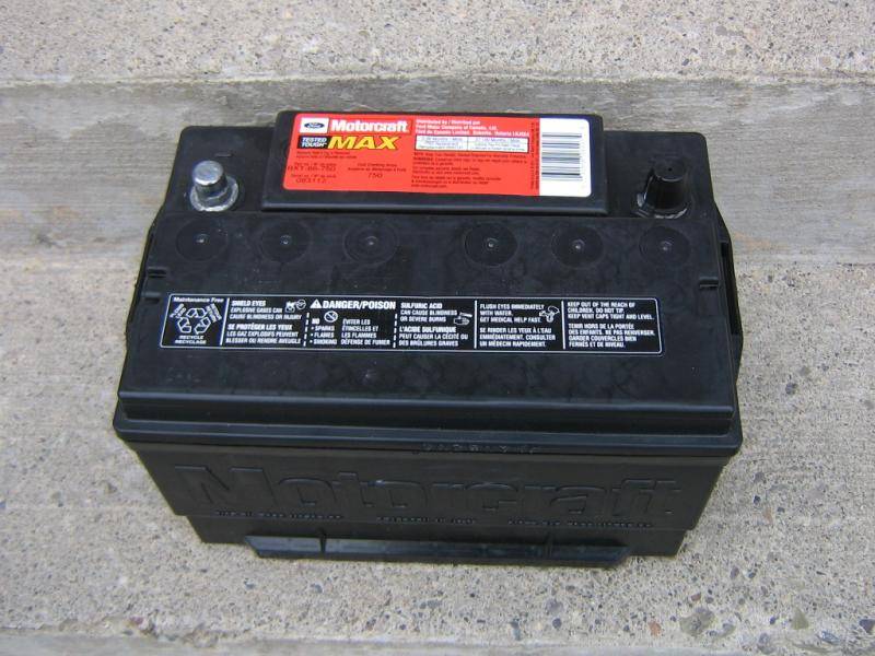

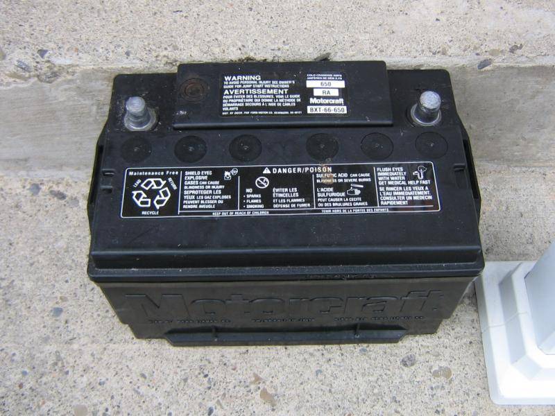

replaced the battery didn't help with the shifts or the E break light
at least the car starts in the mornings now lol
IMG_2113.jpg new battery from Lincoln dealer 750 cranking amps
IMG_2114.jpg old battery
