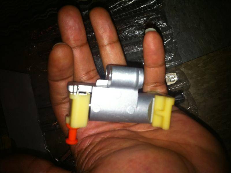

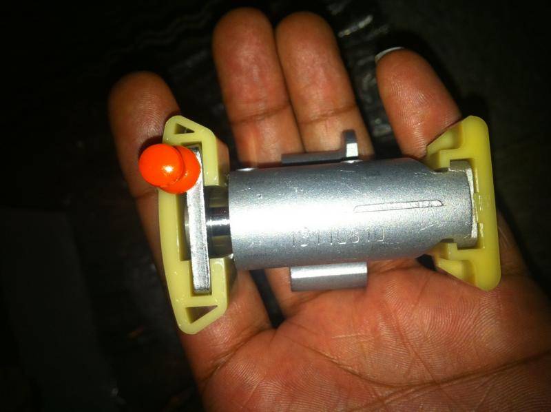

If I had it to do over I would do it the same way. I think it would be more trouble to pull the whole engine with everything that is attched to it. You'd still have to disconnect A/C lines, fuel, exhaust, tranny, heater hoses, hydraulic lines for the fan (GEN I), wiring etc. From what I have read it's easier to drop the motor with the subframe from underneath then pulling it the classic way. Personally, I wouldn't want to do all that....I just don't see an advantage to it.

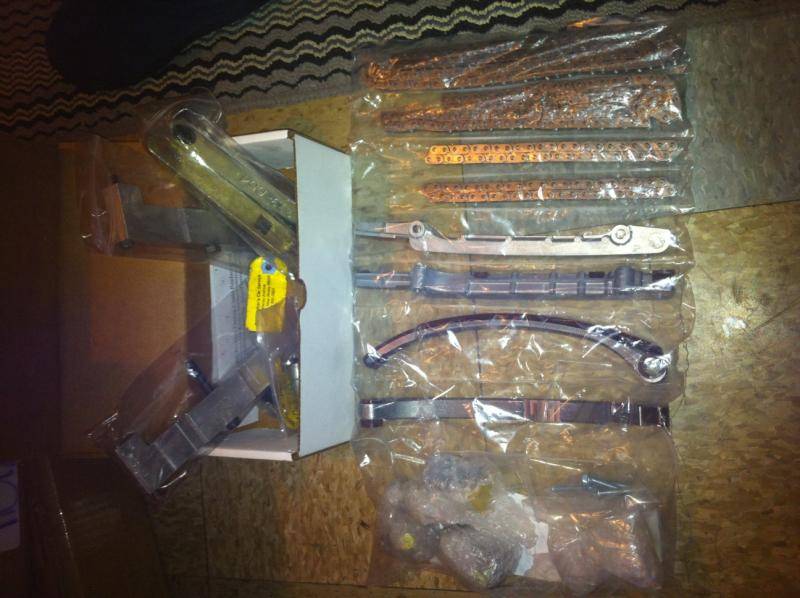

I spent around $900-950 for all the timing chain components and that was everything from tensioners, tensioner arms, chains, VC gaskets, front cover gasket etc. I bought the parts from Max that used to cut some deals for us members, but I don't think he is around anymore. I spent some extra while everything was apart, like a new A/C compressor, water pump, sway bar bushings, coils. I figured if all that was out I might as well do it all at once....not that you would have to do that obviously.
