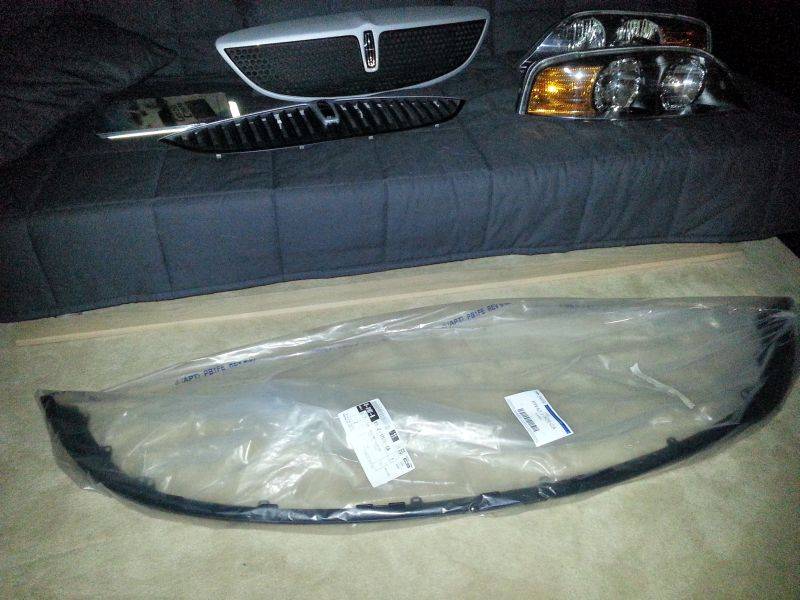

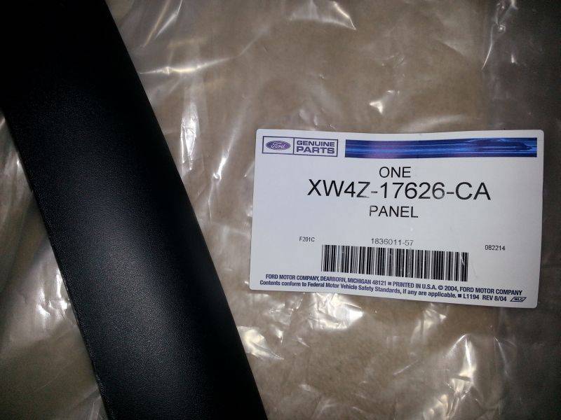

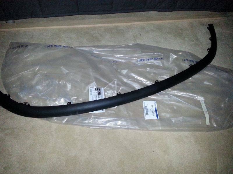

Ordered new Front Bumper Valance Panel (P/N -17626) on Monday morning, was ready for pick up today. (Tuesday) :confused:
Cheap ... well worth it, old one was all beaten up, couple of tabs broken.
- Couldn't get new Emblem though, have to buy whole grille or rear surround.
- Also no longer able to get back up lamps for 01, no longer in service, will search eBay for new ones.
- Also not able to purchase trunk lid arm rubber bump stops, must buy whole new arm, no thanks! will Macgyver something.

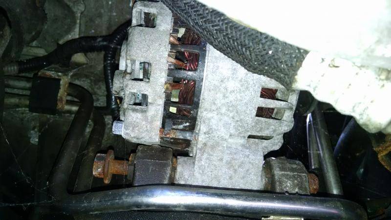

All that money vs a half hour with an 18mm wrench...

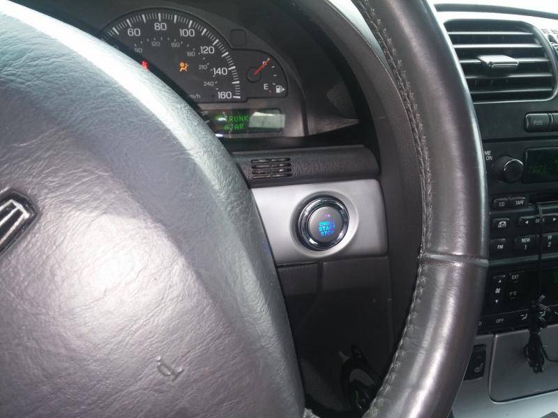

Really not finish today took more than a month testing this system before sharing it and so far so good.
Auto Remote Passive Keyless Entry PKE Car + Button Start Smart System
http://r.ebay.com/OeTBLO
Nice! That's probably my new favorite mod for the LS.

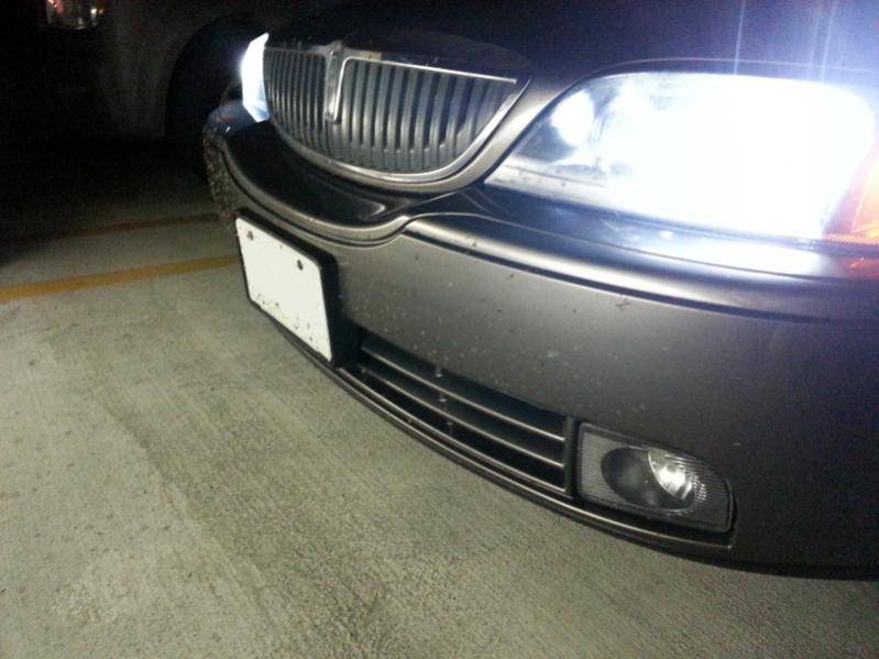

As for me, all I've done recently is give the car a good wash yesterday, then take it for a nice long drive today. Here's the result:
Please excuse the crappy photo. It was dark when I got home, so I used the light from the headlights reflecting off of the wall of my garage to take the picture.
