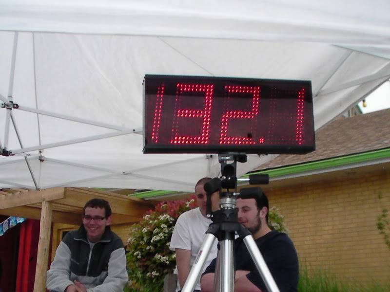

Went to friends at AutoTrendz car show and snuck into line for the DB Drags.
Did better than I thought I would seeing as my system is stock with the only additions being a HU to the stock Amp and then a 13W7 with a 1000/1 amp :D
Thats very good for a trunk mounted single sub. If it was a hatchback or SUV you would prolly be 2db higher.
I was trying to do mine the other day but the db meter in my phone peaks at 125 so it just kept erroring. :(
Yeah my friend who is gonna be the owner of this shop one day told me it should have been a 140 with the Amp and Sub I am running. I was like gimme a break I haven't taken any sound deadening out from behind the seat.
At least I was fairly high up as compared to some of the cars there that looked a bit more serious than what I threw together :rolleyes:

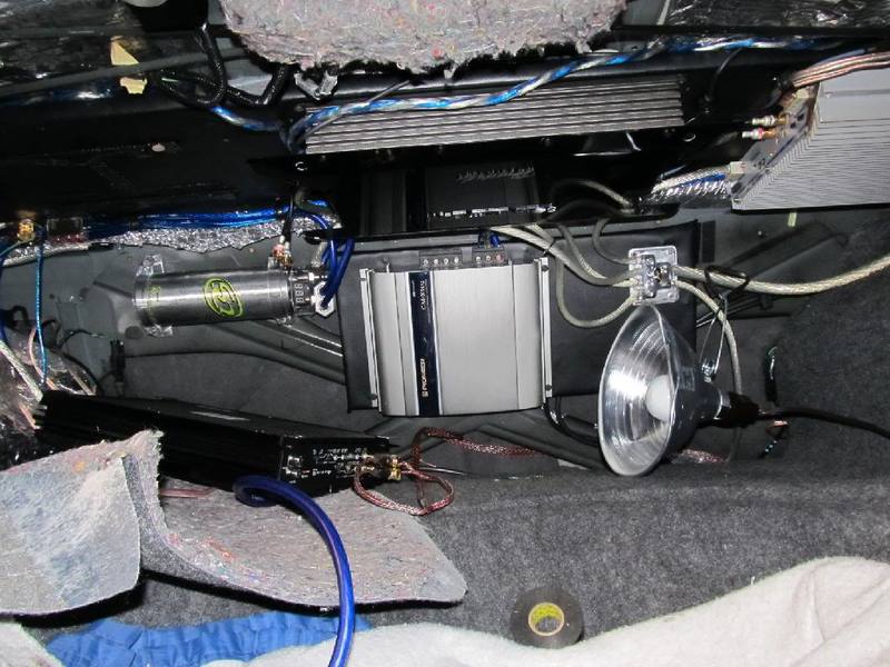

I see at least 1, maybe 2 amps that will be over heating and shutting off. Heatsinks mounted upside down in a hot trunk = cut off.
Not true. If an amp has force cooling then it does not matter. Class D does not matter. A well made class AB does not matter. Only lower end amps and class A does that become an issue. Amps can still dissipate at near 90% efficiency as if they were right side up.
Its been in the 90's here and I pound the hell out of the stereo. My amps are upside down and I am pushing near 3000 watts. No issues at all. Hell, my class D amps don't even bear a sweat and the class AB is never too hot to touch.
I'm assuming you know what those amps are when you say well made? I'm seeing a Pioneer amp in there too and that's a Wal-Mart amp. I could only imagine what the other two are. Class D, yes, they can pretty much be mounted in different ways and I don't see and haven't seen any mention of a fan being put in that contraption back there. The most common ventilation method, convection cooling, also happens to be the simplest – and provisions for it are built into most car amplifiers. Convection cooling works like this: As the amplifier heats up, warm air is transferred to cooling fins, usually part of an aluminum heat sink on top of the amp chassis. The fins radiate the heat into the air, where it dissipates. As the warm air rises, it's replaced by cooler air that's sucked upward from beneath the amplifier, and it is this continuous circulation of cool air that prevents the amp from overheating. Convection cooling works fine as long as the warm air can dissipate and cool air can move in. Amplifiers should never be mounted in an air-tight enclosure. Instead, mount them on a vertical surface (when possible) in an open space, preferably with their fins running vertically rather than horizontally and never facing downward.
Not trying to argue but amps with fins on the top being mounted upside down, isn't very good and if a fan is being placed back there, then there shouldn't be a problem. I still wouldn't do it and I surely don't want a fan in my trunk running all the time. Seriously Bill, would you mount all of your equipment like that?

I dont know what he has, nothing looks special in there. I was refering to your comment, not his install. I have been doing systems a long time and never heard of "convection cooling" in an amp before. I have heard of convection ovens. I have heard of liquid cooling systems for amps. But thats it.
convection /con·vec·tion/ (kon-vek´shun) the act of conveying or transmission, specifically transmission of heat in a liquid or gas by bulk movement of heated particles to a cooler area.convec´tive
