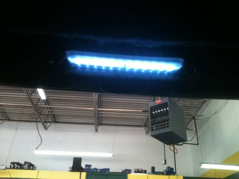

Installed this in my trunk, center top by the cyclops tail light... Makes much brightness in there now :)
It's a rear license plate light sold at Pepboys, for about $15
Thats Cool! You just gave me an idea for where to put a blue 24-LED light strip I got off Ebay! My trunk could definitely use more light and it would match the blue LED theme of the interior!:)

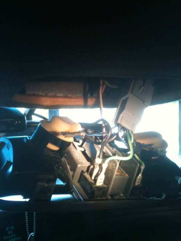

I didn't like my reading lamps coming on when opening the doors since I have 7 bulb LEDs in the rest of the enterior. I think it took away from the effect. So I just disconnected the black and blue stripe wire from the switches. Now the reading lights only work via the switch :)

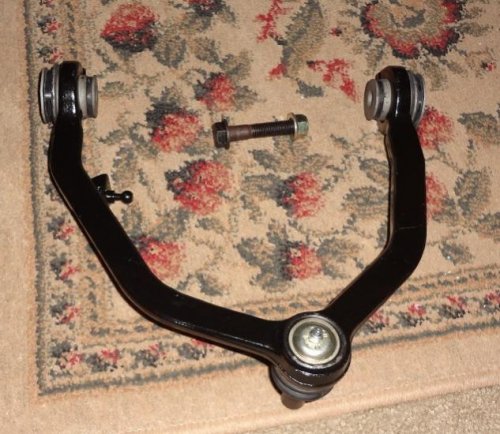

Didn't get to start on the front air shock on the '97 yesterday like I wanted to. Hopefully, I'll have my new UCA today or tomorrow and I can do the solenoid and UCA at the same time. And this time I'll remember to grease the dam ball joint!!!!! Looking forward to getting the car back on the road again. I love driving the Exploder, but it just ain't the same as a Mark!

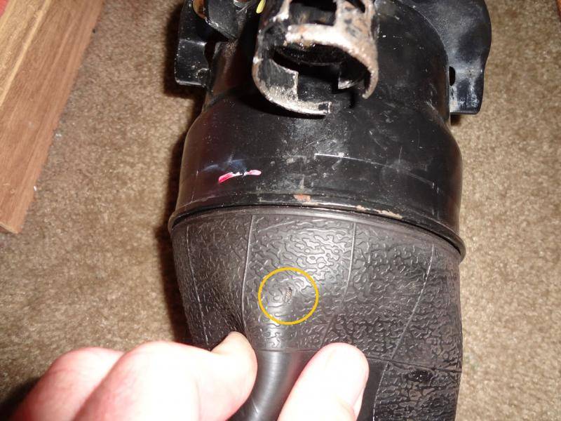

Okay. I'm pi$$ed! I just replaced the solenoid on the d/s front air spring on the LSC and it still hisses. Turns out it's leaking from where the hose plugs into the solenoid. Anyone else ever had this problem? This is really annoying me terribly.
But on the plus side, I did get my UCA installed and no more squeaky-creaky:)
Okay. Update. As it turns out, it was the air spring that was leaking. It had developed a leak on the back side of the spring next to the solenoid. That's why I thought it was the solenoid leaking. It's a hole about 1/8" long.
The good news is that I contacted Arnott and they're going to send me a new one under warranty. The only drawback is that I have to ship the defective one back to them and wait for the new one. That sucks. But at least I'll get a replacement.:)
