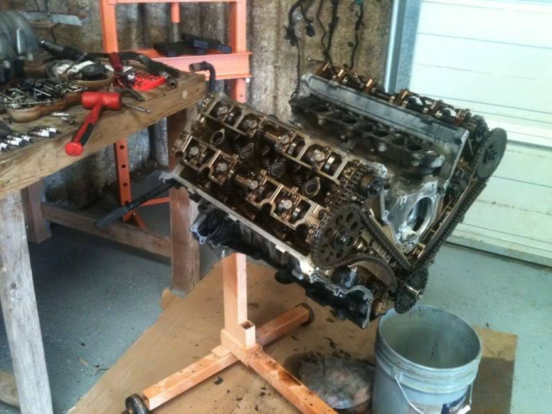

Turned it into a pile on my work bench
Wow, looks like you had fun tearin that apart.

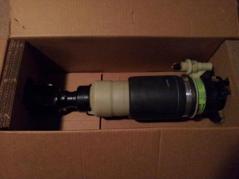

The new air shock finally came in today for the passengers side. It was leaking over night and nose diving. Sometimes it would nose dive within a matter of hours. Not anymore. Just as soon as I found it on the porch, I took it to the garage and put it in. Even when I finished and let the car back down, it aired up within no time. My compressor is from American Air and only a little over 2 years old. I'm going to go ahead and order the drivers side and then I'll be done with the front end for a while. btw, the bags that were on my 95 did come from a 98. Jamie had put them on before I bought the car. It wasn't leaking then but within the last few months, it got started.

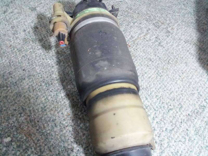

Old one before removing.
Up close to show the cracks.

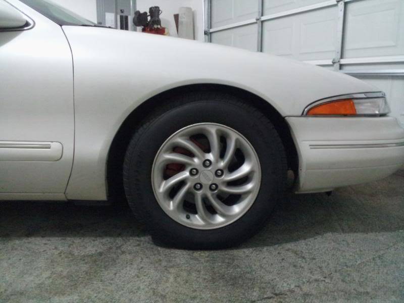

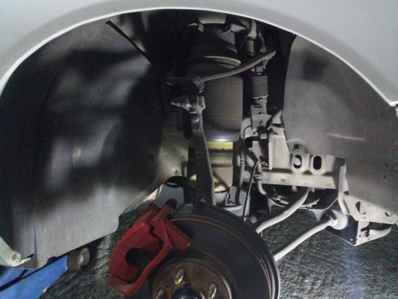

Finished and this is how it sits after venting. It is sensor lowered. Sets right at 27 1/4" after venting.

I went back out and sensor lowered the rear to get it all even. Now at venting, car off, it's sitting at 27 1/4 on all four corners. Less work on the compressor, vents fast and looks much better.
Look's great limit95.
I don't seem to see the word "strut" anywhere on that box. Does anyone else see the word "strut"? Me neither. Looks like Mark VIII's don't have struts. At least Ford Motor Company (the folks who designed and engineered these cars) knows the difference between an SLA suspension and a strut suspension:rolleyes:
(Sorry, couldn't help it. I just had to go there:D)
Congrats on your new front air shocks NoLimit! It's always nice to know your car won't be slammed an hour after you park it!:)
