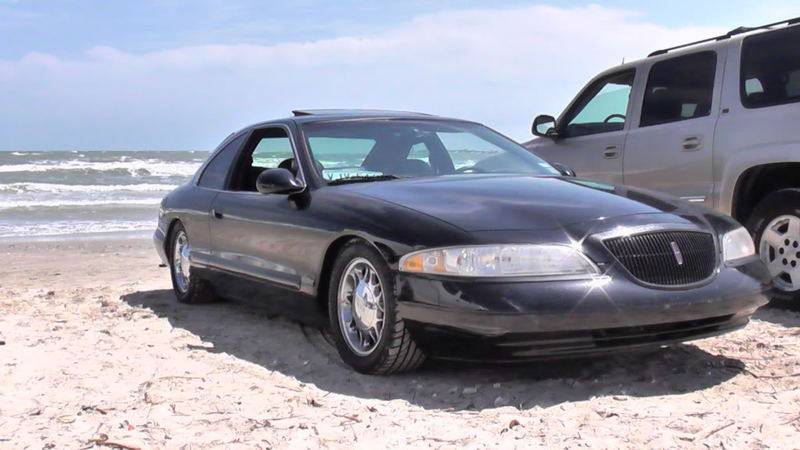

We can all cheer...we DIDNT do what rippedcamel did :) I kept my car alive today, added 10 gallons of 93oct and took her for a spin
Wow you put your Mark that close to Salt...ick
