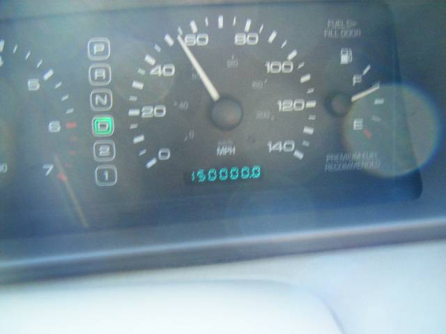

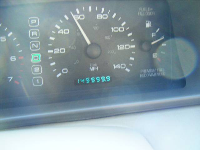

And she made it back in one piece.

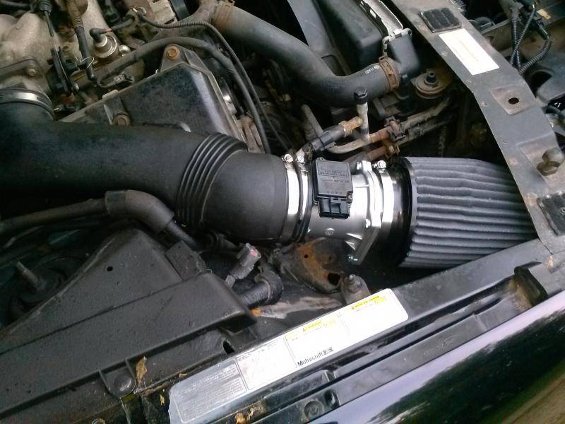

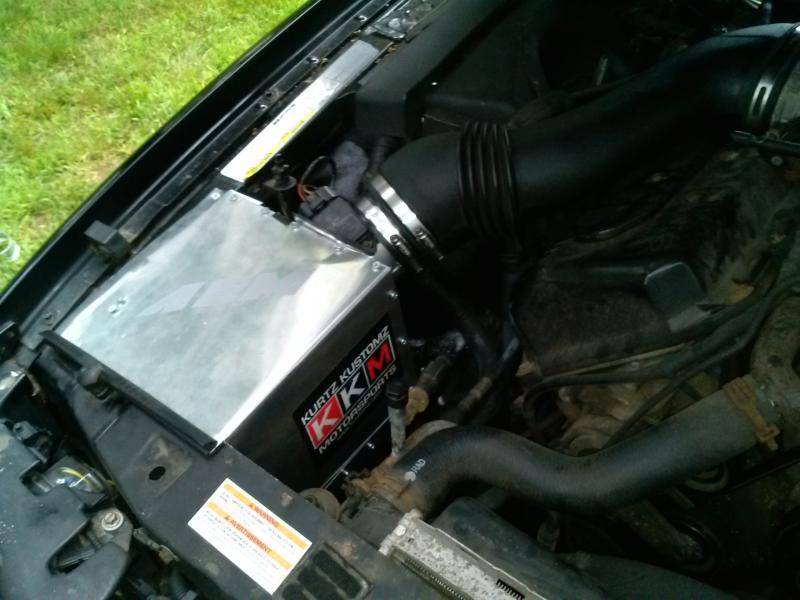

I Installed a custom made ram/cold airbox incasing a 9" AEM dryflow filter, removed air silencer and ducted a intake tube down to a fabricated scoopCAM00301.jpgCAM00316.jpgCAM00317.jpg

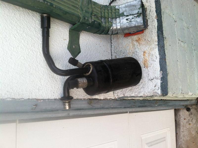

I pulled the A/C accumulator out of mine since it blew the o-rings on it. Just waiting for the new on to come in.image.jpg

How did you adapt the MAFs to the stock tube and the filter to the MAFs? The tube is like 4 inch and the MAFs is like 3.25 or something like that.
I went to Home Depot got a 3 inch black PVC rubber coupler with worm clamps on it slid a piece of 3 inch PVC pipe in there the rubber coupler clamps down to the mass air flow meter and since its so thick with a hard piece of PVC in there it fits perfectly In the stock intake snorkel and it clamps right down I did on my research on this site before ordering the parts the hardest part was fiTting the nine inch AEM filter and the hook the filter to the mass air flow meter I had to order A adapter flange from kurtz kustoms 80mm ford mass air meter adapter
