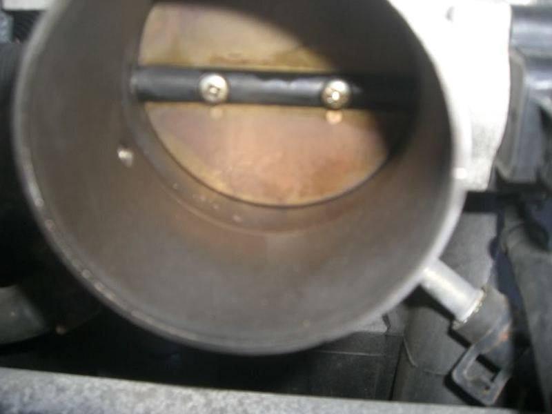

I'm taking the throttle body off to pollish the outside. Should bring out some ooos and ahhhhs when people see it. My question is this. I have some mustang buddies who all did a PnP job to their throttle boddies using a dremel. They claim to see an improvement. I have never heard of this. I know people have theirs done, but a dremel seems like just a clean up obvious obstrustions type of job and i dont think these cars had too much of an issue. I'm hoping to get some thoughts and comments on this process and if it should be done, avoided, or just kinda doesnt matter. she is coming off this weekend to have the OUTSIDE pollished so that would be the time to do it if I am going to.
theres a lot of slop from the factory in the tb's, I opened mine up one saturday because I got bored and there was almost an 1/8" overlap between the throttle body and the neck it bolted to :( lol dunno weather it did anything or not feels like it did, might just be my brain gettin in the way
hmmmmm maybe I'll take a look and clean it up some. I thought with these cars be such a damn expensive platform for ford to make that they'd be somewhat decent. Time to grap the calipers and see whats going on I think.

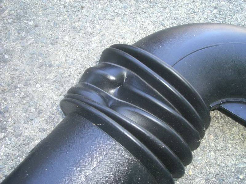

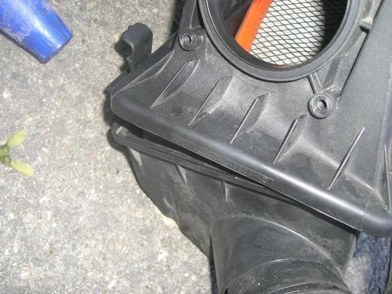

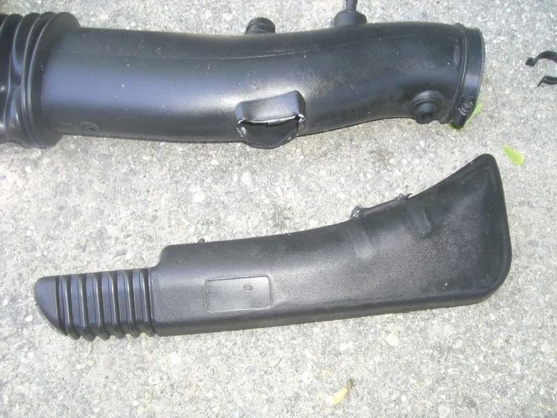

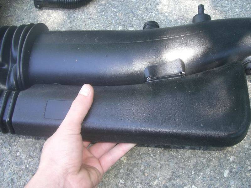

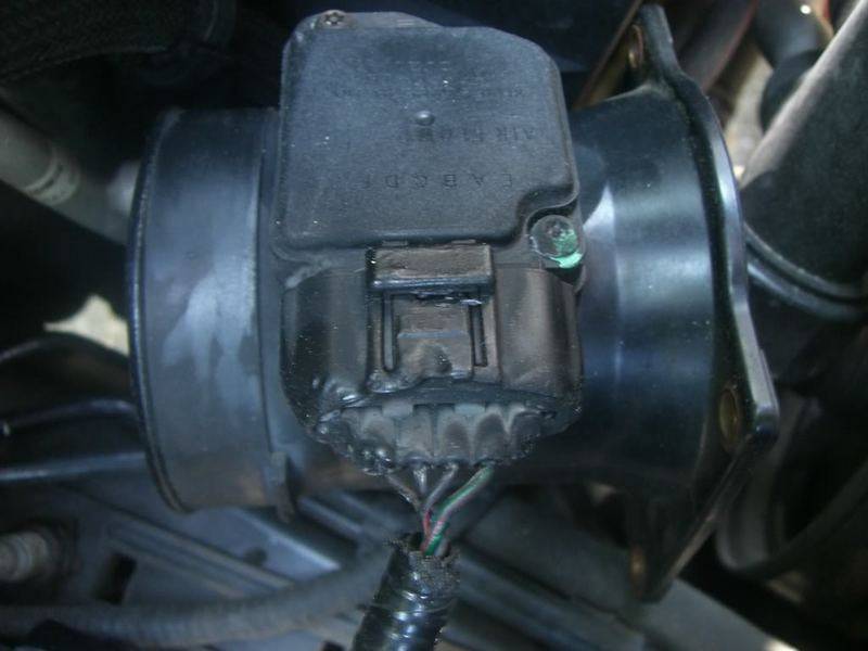

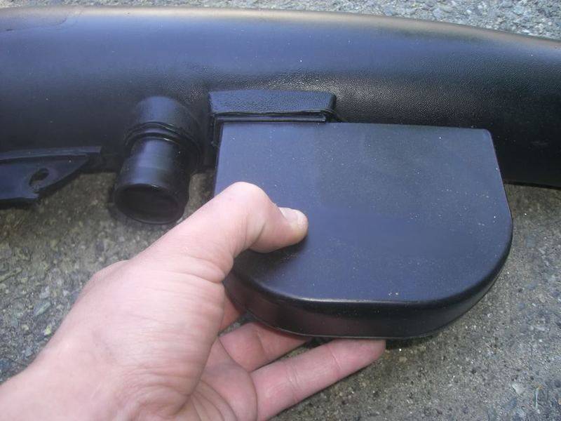

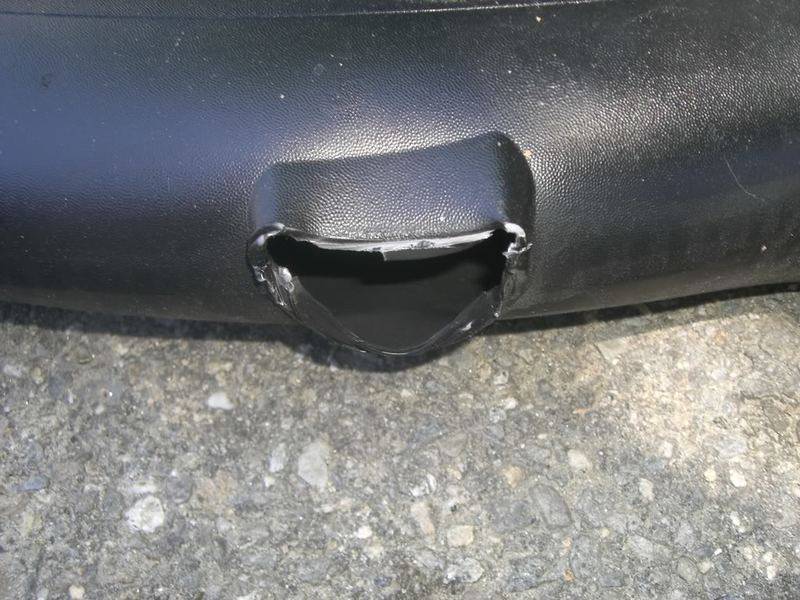

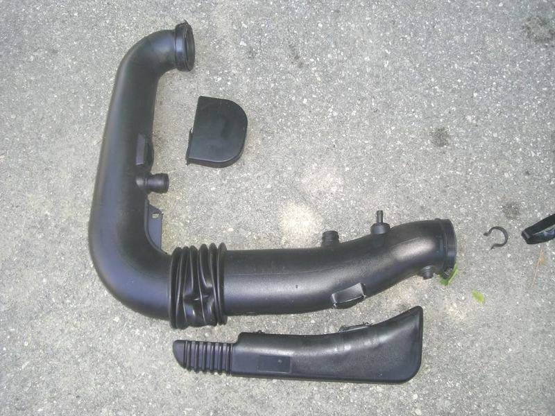

ok so I blew up the damn intake and maybe some other stuff at the track last wednesday. There is a thread about it somewhere. Here are some carnage pics for your viewing pleasure:
shes was running on duct tape that same night. I had to drive away from the track so AAA would tow her

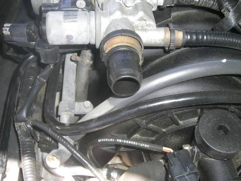

anyone know how to PnP a throttle body? I was thinking about cleaning it up while I have everything broken down
Now, I have been accused of not being too smart at times so take anything I say with a grain of salt and I haven't actually done this, so take that into account also. My understanding is that you basically want to make sure the transition from TB to the manifold is as smooth as possible, basically making sure they are the same size I.D. all the way around. If the TB is smaller than the intake you could be looking at a "bottle neck", which is bad. I've also heard of grinding the head of the screws that hold the "butterfly" to the shaft down a bit so when it's W.O.T. thats a little less restriction. Is there more to it, probably, but thats what I know. Will you see a difference, no, probably not a big one until you have the TT's set up, but hey, it's fun the grind stuff regardless right?

where did you have your nozzle mounted?? pre- MAF? your actual intake looks fine, just the air tube... you're a lucky SOB! :D
pre MAF? no its a wet kit. Went just before the TB
i was just surprised to see that much damage to the air intake all the way down to the filter. i figured you may have put it just after the MAF... or further back from the throttle body. it sucks fitting a nozzle on the underside of a gen1 intake doesn't it.
not really..... got it first shot and didnt even plan out the clearance under it. Just figured out where it would spray best and anstalled. Got lucky I guess
too much nitrous and not enough fuel...... sprayed at about 1k rpm...... not enough flow yet for nitrous to be flowing

Some noticeable differences are evident though. I had the TB off anyway and since I had like a 1/4" bottle neck, I decided to gasket match the throttle body section and the the intake. Much less restrictive air flow now. I dont have cats, so what little bit of resistance they gave is gone. I have been running the CAI i made for a day or so (still not painted) and she is breathing nicely. All and all with my KBX Performance tune and the minor mods I made while she was down, this car is running like a raped ape right now! I cant wait to get my bottle filled and see how she runs on the juice! Oh yeah. I also polished the outside of my TB and while its not done, the subtle accent it provides to the engine bay look stellar!!!!! Hope fully my camera will work so I can get a pic of it up here.
